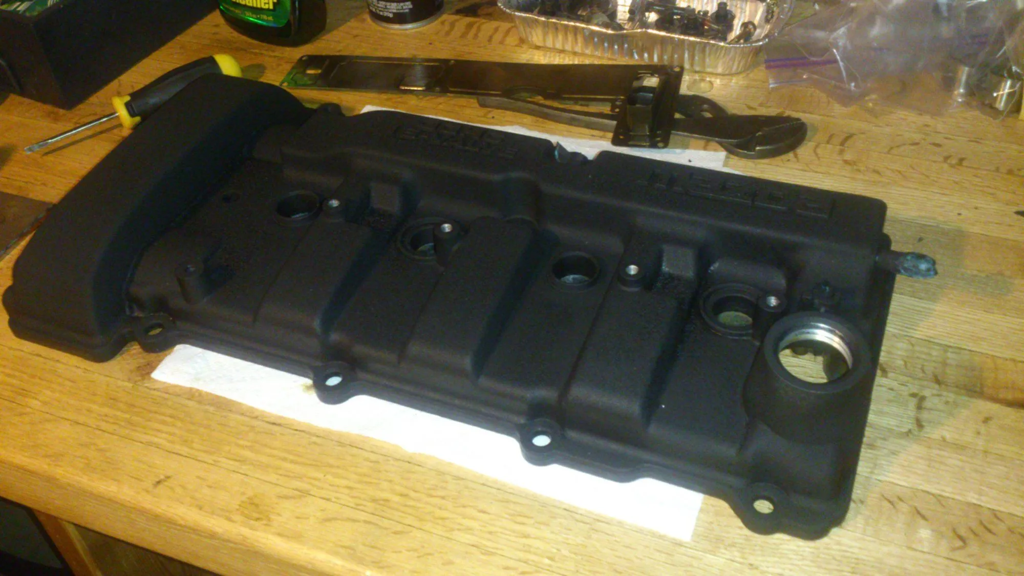

Painted the valve cover, and made a matching window cut out in the upper timing belt cover...pretty happy with the results...
