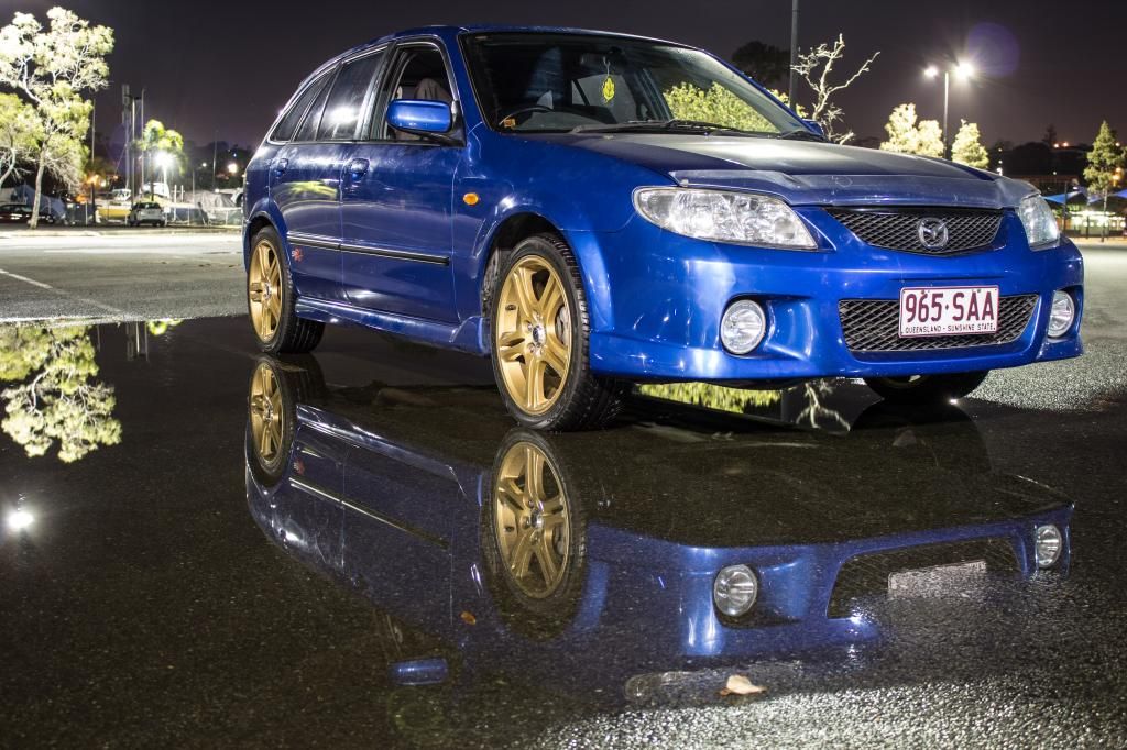

A shot of my dirty car from the other night:
A simple but really nice ride Ice. My Sport20 is now back on the road after two years parked(was impossible to find a 4WD box - after destroying a gear). I got another engine with a 2WD box. It's pretty ok, a really fun car to drive but, this fs engine I know has a great deal more potential as N\A. The only mod I've made so far is to replace the factory air box and replace it with a short ram and high flow filter infront of the MAF sensor. The factory plastic intake between the throttle body and the MAF sensor is still there, don't know if I replace that with piping it will make much of a difference. Still have the factory cast iron exhaust header on there - I'm thinking of going aftermarket but now sure if it will make a difference.
