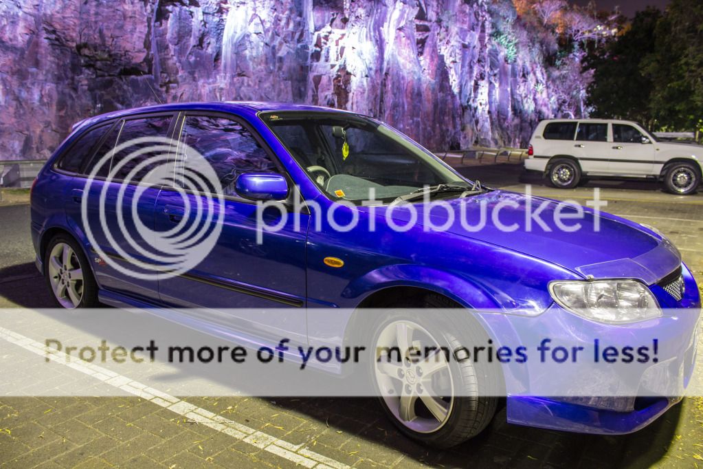

Rising from the dead. Finally bought a car last week. Yesterday at AGT Mod Day:
Car With Stockies:
Teaser Shots of Car with MSF Rims:
^^ Images expand to full size.
