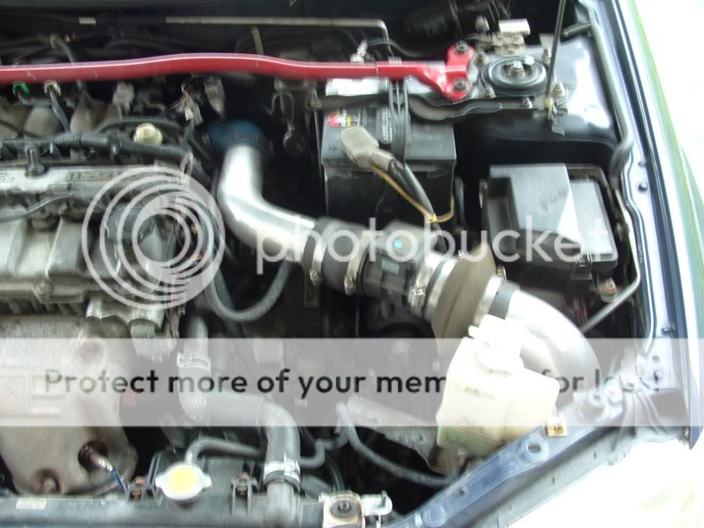

Here is some picture of my X3 ebay intake (injen style)
Yes that is an AEM bypass
