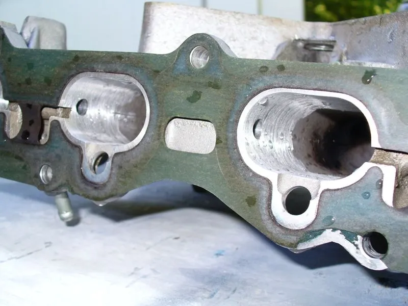

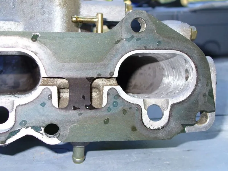

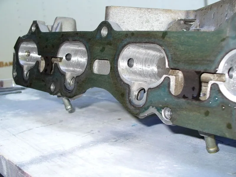

Got mine ported only took me an hr now I just have to go over it with a finer grit.
you should gasket match it since you have it off
Unless your Protege is turbocharged/overly built, I wouldn't suggest gasket matching, perse. While it can allow greater laminar flow at higher RPM, at lower RPM, the velocity loss will be substantial. Just an FYI. Looks good, Laser. =)
- Eddie
I opened it up pretty much alrdy if I go much bigger it wont really help neways cause the rest of the port is alot smaller.
