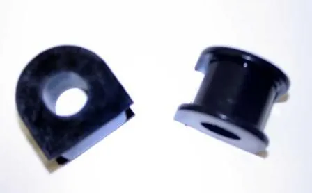

2 AWR MP3 Urethane Replacement Bushings
They are red not black not sure why they are like that on awr.com
Image #1

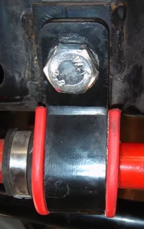

This is what it should look like when you're done.
Image #1 & 2
This will make the rear suspension a bit more rigid and I did not hear any noises associated with this mod and most important no CLUNK.
Home Depot's bolts are 17MM instead of 14MM on the head but still 10MM on the thread so they fit just like stock but grip a lot more space on the bracket.
