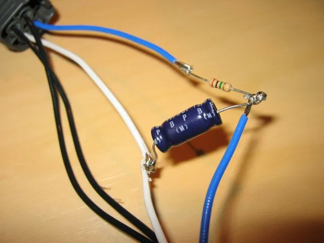

can someone who has done this AND IT WORKED PERFECTLY for them please post the exact parts used. Ive tried 3x and after about 50 miles its back on again.
Thanks
i dunno what the part #'s were for it all, but heres a pic... i guess you could jot down the markings on the larger part and get that piece, the other smaller ones come in bundles of 5 i think and should be the easiest to find.
this setup pictured has lasted so far 3500 miles and counting.
hope it helps!
hope it helps!
Are you just running a header or a turbo? The small part looks like mine. The larger one looks different. I'll go to radioshack tommarow and try to find it.
just a header.
the larger part is a beefier piece than needed and it can not be hooked up backwards which was a good safety measure for me.
dosle said:
just a header.
Maybe thats my prob. Mine might have to be a certain way. Cool thanks for the help.

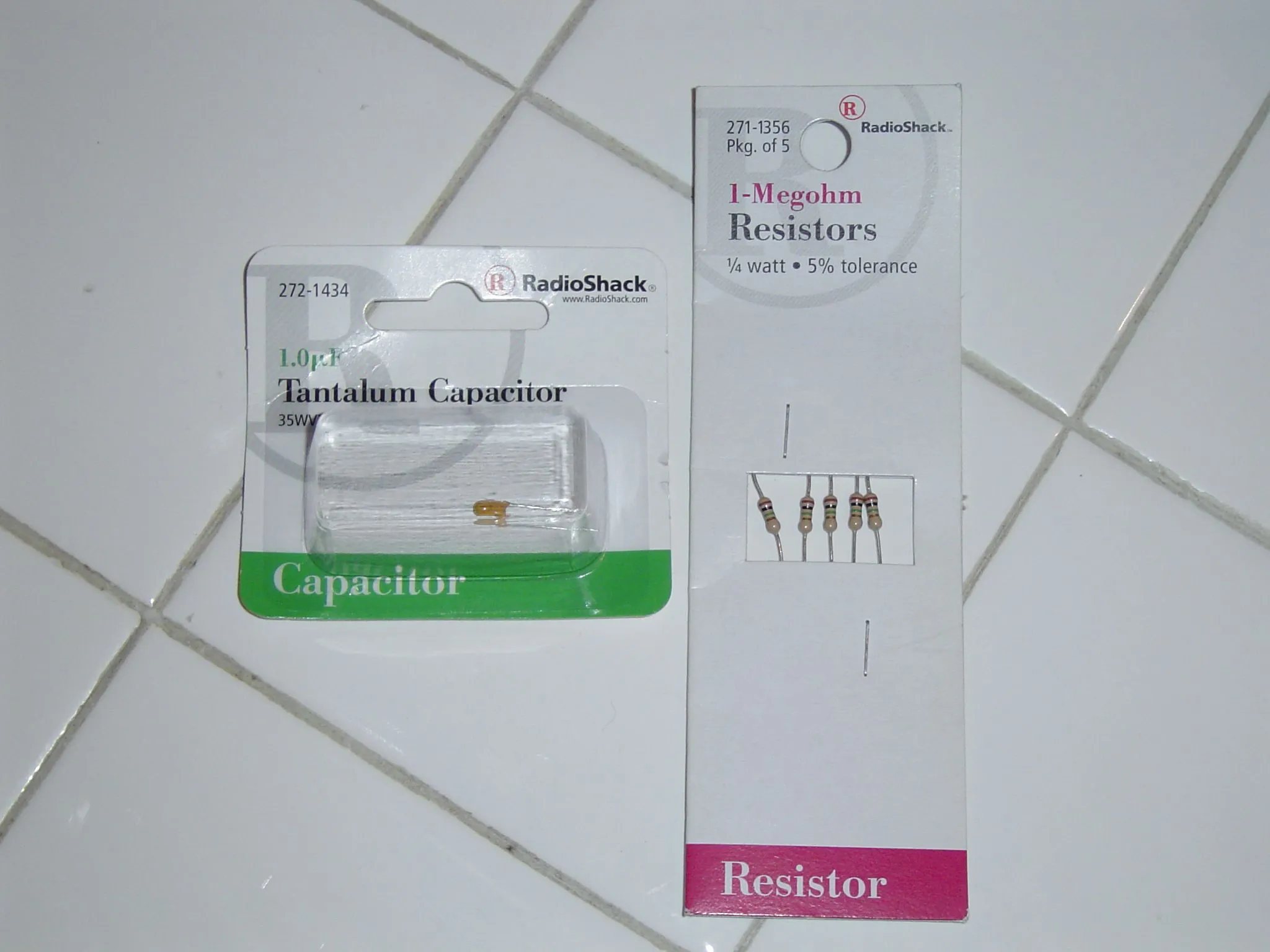

If you look back at one of my posts, it has the exact pics of the ones I used. Here they are:
That cap is even different from all the others I've seen. I'll try that too, why not.
Don't know about anybody else, but I have had this combo on since the beginning of the thread and no issues. It has the part numbers you asked for, so this is at least 1 winning combo.
