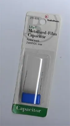

Does it have to be a uF capcitor??? I bought a capacitor, but I'm not sure if it's a uF.
LOL yes it does matter it must be EXACALY 1uF (1 micro Farad) or else the sign wave it makes will be off or out of phase or something and the ecu will b**** at you again
my cap is diff, I'll scan it and someone please tell me if its right?
(sorry the dig cam is on loan right now)
