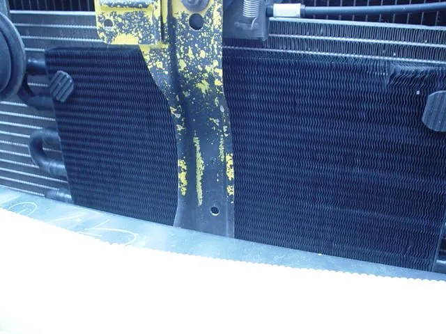

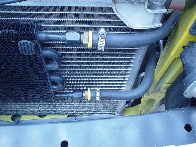

Alsa i meant to ask how exactly the tranny cooler mounts because Ive heard it uses the a/c something or other and i don't have a/c, is this a problem?
The tranny cooler mounts on the front of the AC condenser. If you don't have one, you can just as easily use the radiator. AC doesn't really have a direct impact on being able to install a tranny cooler, it just helps with mounting.
As for the Lentech transmissions, I spoke with Lentech earlier today and they build separate transmissions for the Protege and Focus. Mazda ones have to be ordered in advance because they're not as popular, and the Focus tranny would not be a direct bolt on.
