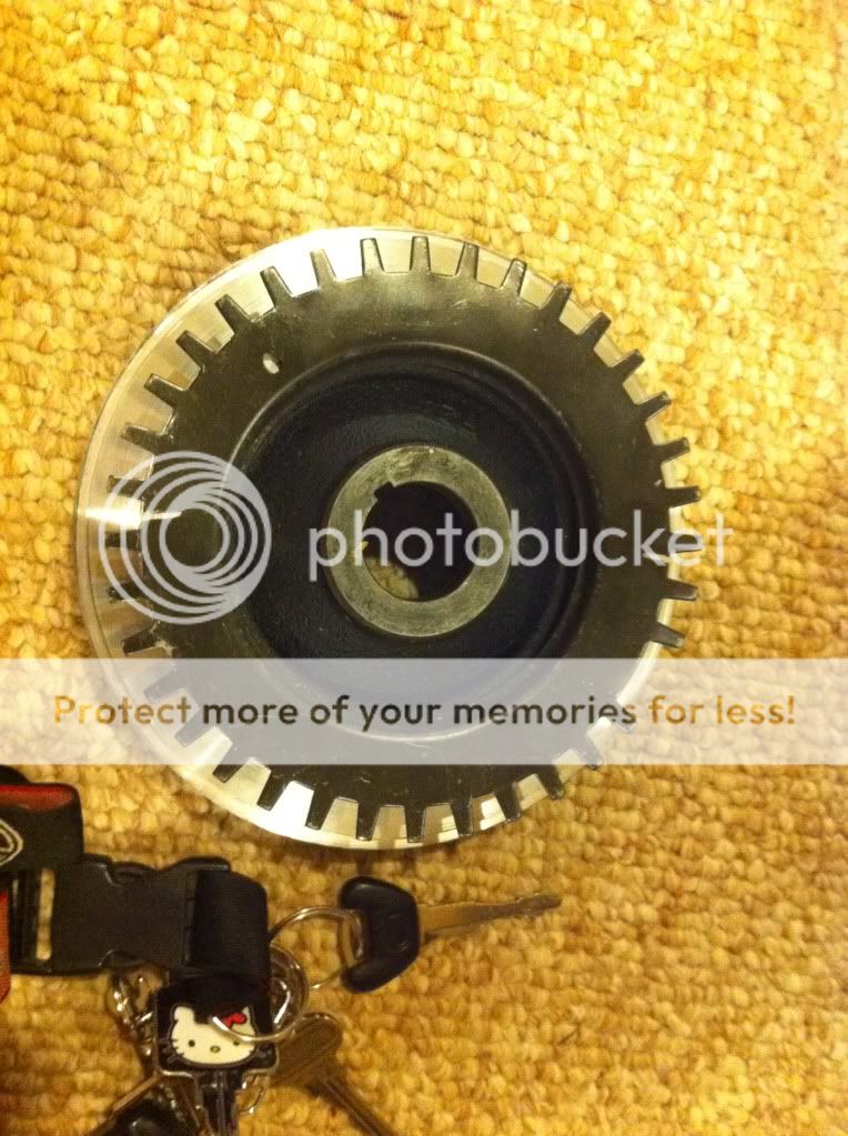

^^ love how slide wants multiple and yea wanna see that dyno chart when you get the pulley on if theres enought room down there might askk pops to make a bigger one??(sssh)(boom07) maybe a new sc pulley as well? (thumb) but first things first waiting on the kit in the mail then gotta figure out the install (ugh)(sad2)(yupnope)
Well if you google they will show you calculations for the maximum RPM this supercharger can handle. It will also show you what kind of boost levels to expect. Honestly I wooing tho bigger than that pulley. Unless you plan on building the block.

I'm still trying to get this done in the next two weeks. I'm going to out on the pulley then leave the belt for the SC off. Go down to checkers and test fit belts. lol
