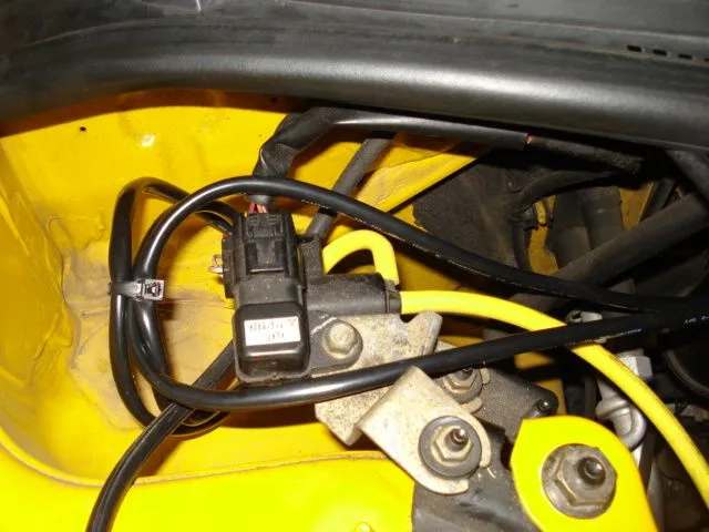

Don't have my camera but the vac line leading straight into the solenoid for the sensor (looks just like the vics and vtcs solenoids) is where the check valve needs to be. The solenoid and sensor are mounted to a bracket for the strut bar just behind the strut near the firewall.
NA protege's use an egr boost sensor which tells the egr when to open. MSP does not have this sensor so no problem for them but when you boost an na protege the check valve keeps boost from hitting the sensor.
These were part of the Hiboost Kit install instructions and I have read similar cases of the OG na gone turbo guys as well as other makes too.

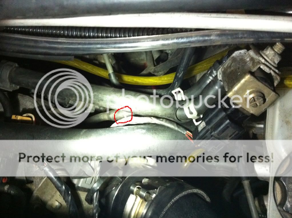

I'm assuming you don't also have a check valve on the vac line just behind the throttle body that leads to the purge solenoid valve. This keeps you from applying boost pressure to your gas tank.

you guys are talking about the check valve before the charcoal canister right? wish I could help with the EGR, I removed mine....
This?
