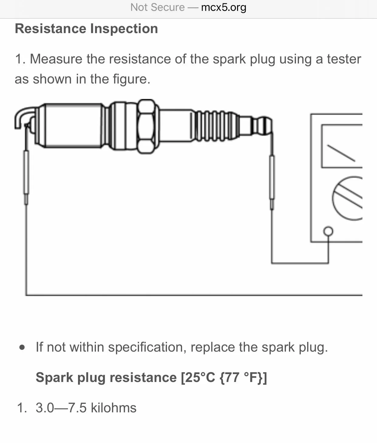

If you think OVT is not good enough, I’ll use true Mazda expert who designed the SkyActiv-G engine! Here’s what the Mazda CX-5 Factory Workshop Manual says:
CAUTION:
• If a spark plug that is not as specified is installed, engine performance will be deteriorated. Install only the specified spark plug when replacing.
Which means to install only Mazda Genuine spark plugs! And measure the resistance of spark plug and see if the plug meets the specification:
NGK makes the OEM plugs! I'll throw some exclamation points in for emphasis! The part number is the same! But thanks for the shop manual snippet. Mine says the same thing for the old V6 in the old CX-9. Use only Mazda plugs. Then, when you buy them, they say Motorcraft on the box, because that's who actually makes them (just like NGK makes these ones).
It's your money. Use whatever you want. But I'll bet you $32.37 that the resistance of the NGK plugs is in that range.
