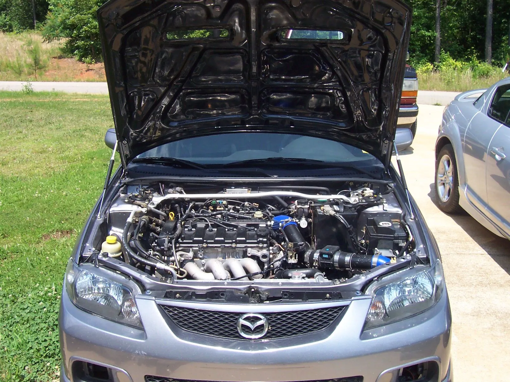

This is how it should look installed.
Mine look a little different but I test fitted for them so they may have changed it a little.

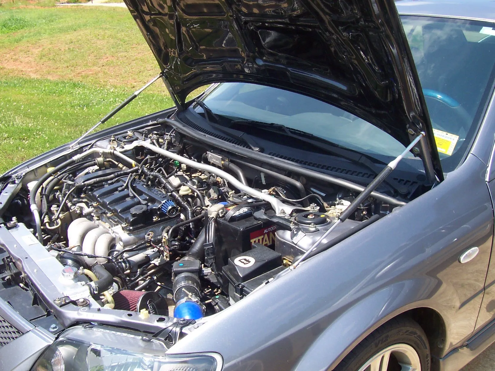

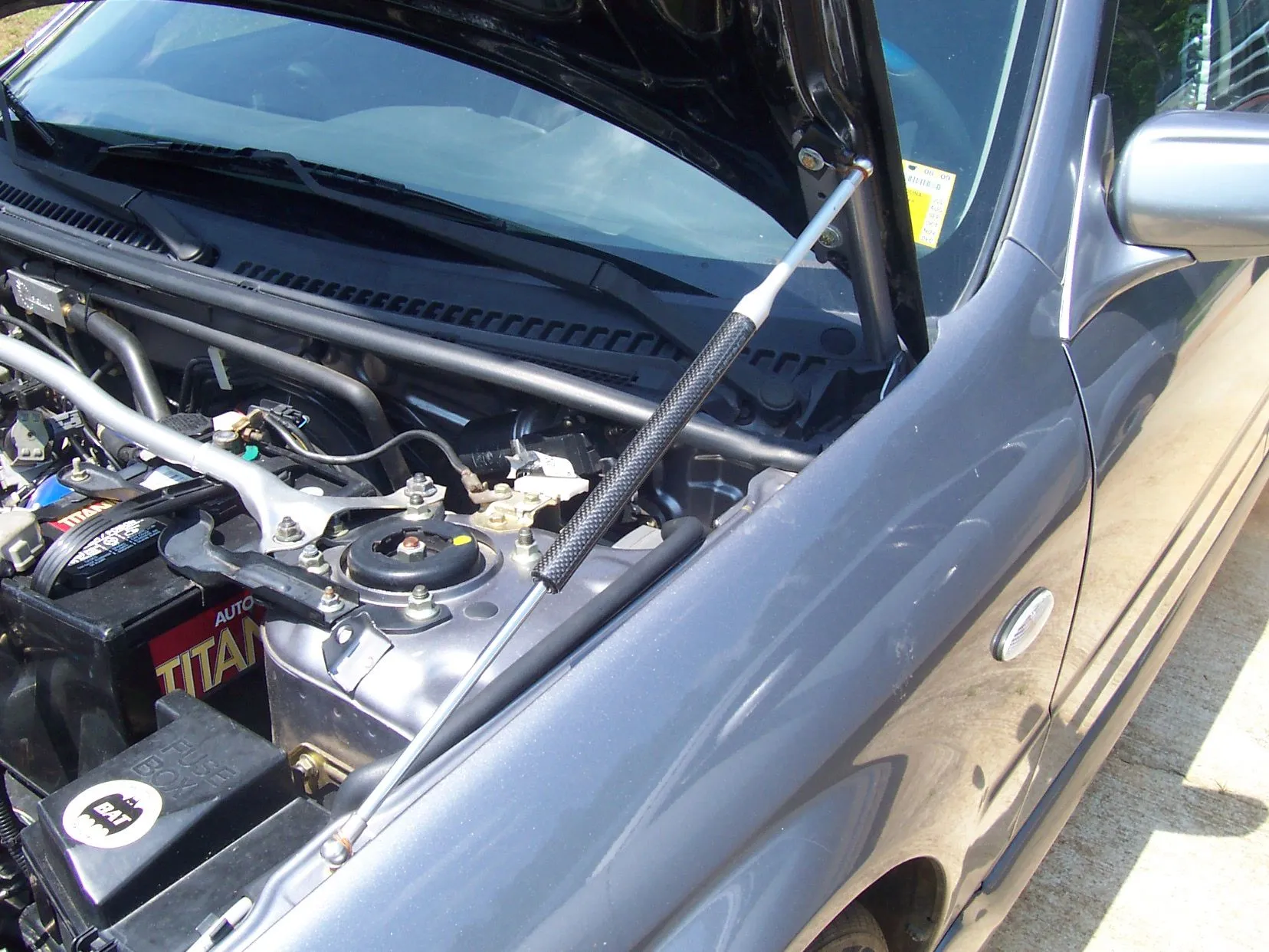

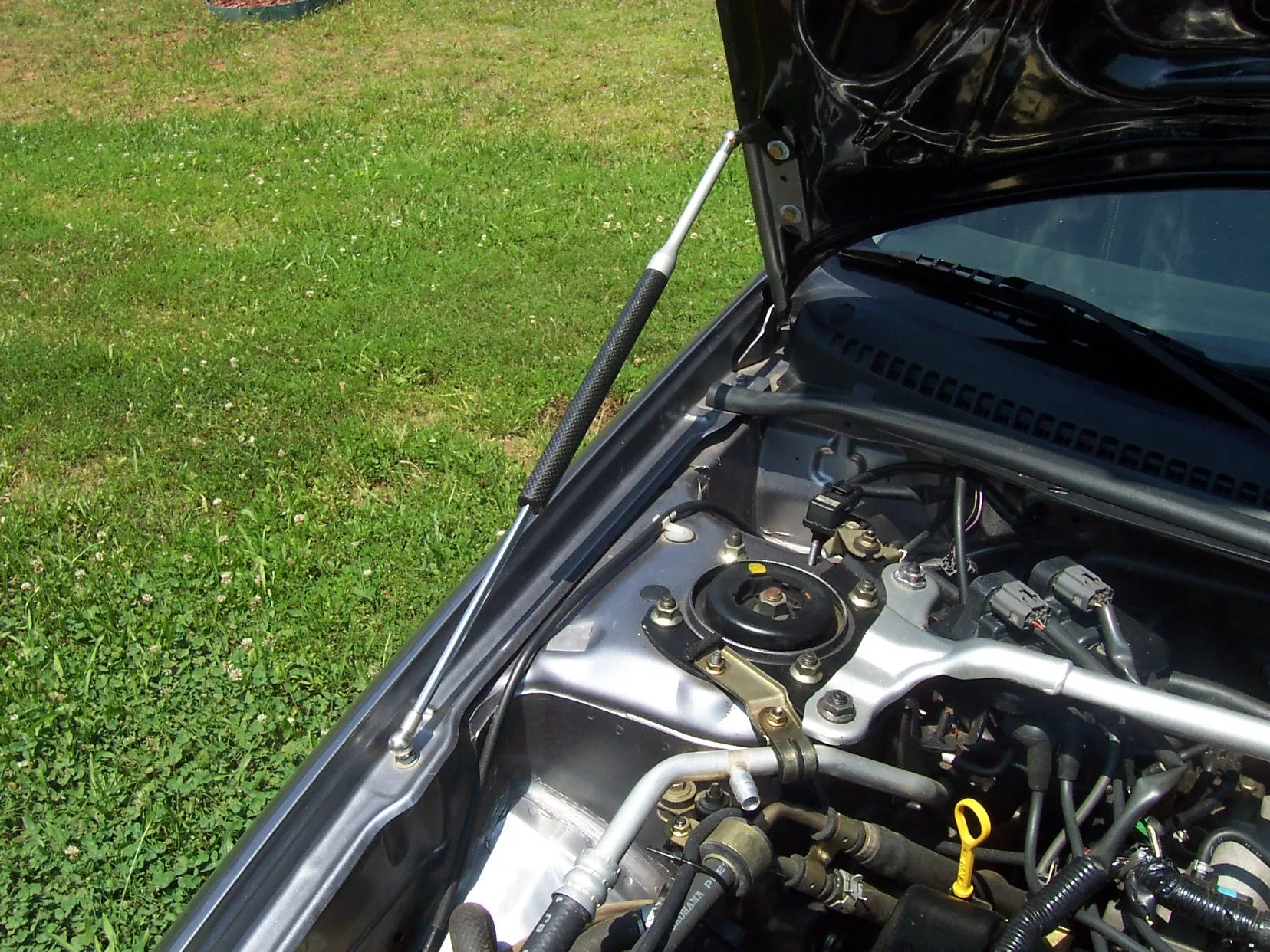

Edit.. here are some photos of mine for reference.. my driver's side one I actually had to wire down because the pressure from trying to shut my hood the first time broke that little pin that goes through the two holes, and it ripped through the ball cover part. The other one was fine though, I just try to be easy with them when I open and close my hood.
