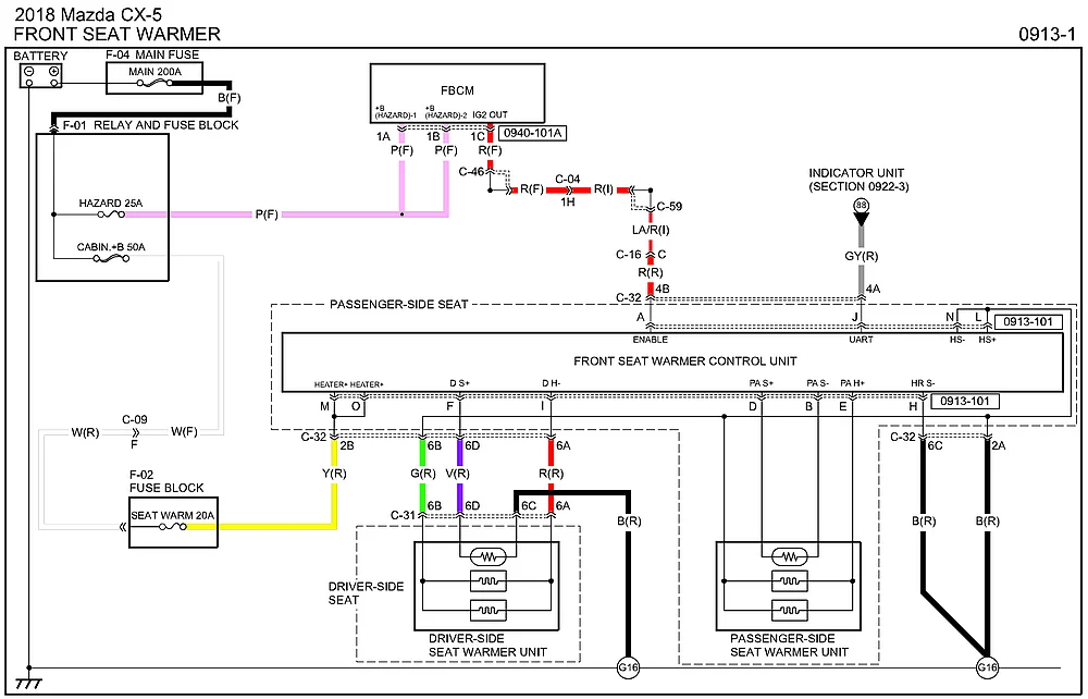

From my wiring diagrams, it looks like the 2 panels are hard-wired in parallel. No separate connectors. Sorry.
Upvote 0
RedBaron, thanks, now I know I will need to separate the circuits. Looks like three heating units? Guessing one for the seat and two for the back? May as well add a switch in case I want it to work again. Thanks, Tom
No, just 2 heaters, the third thing (rounded outline) is a temperature-sensing thermistor. I'm not sure where that's located, but it may be on the bottom cushion/element, in which case it would be dangerous to disconnect that bottom element!
All in all, this is a very bad idea. It could disrupt any current sensing in the controller and have unknown effects. If your butt is getting too hot, just get a seating pad to insulate it!
Upvote 0

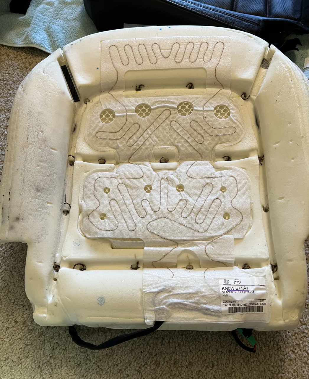

i think this thermistor may be on the lower seat cushion, rear right side below the sticker.

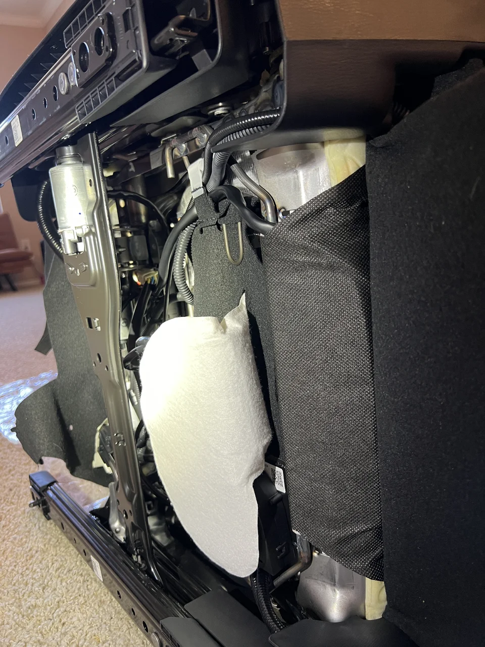

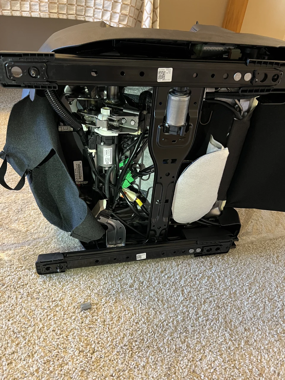

from what I recall each cushion (seat and back) has its own connector which is plugged under the seat. Its been a while since I dissasembled my seat so my memory is vague.
See if this helps. Removing the seat is easy. 4bolts just disconnect battery first.
You can trace the black (not ribbed) cable from the seat cushion and where it connects.

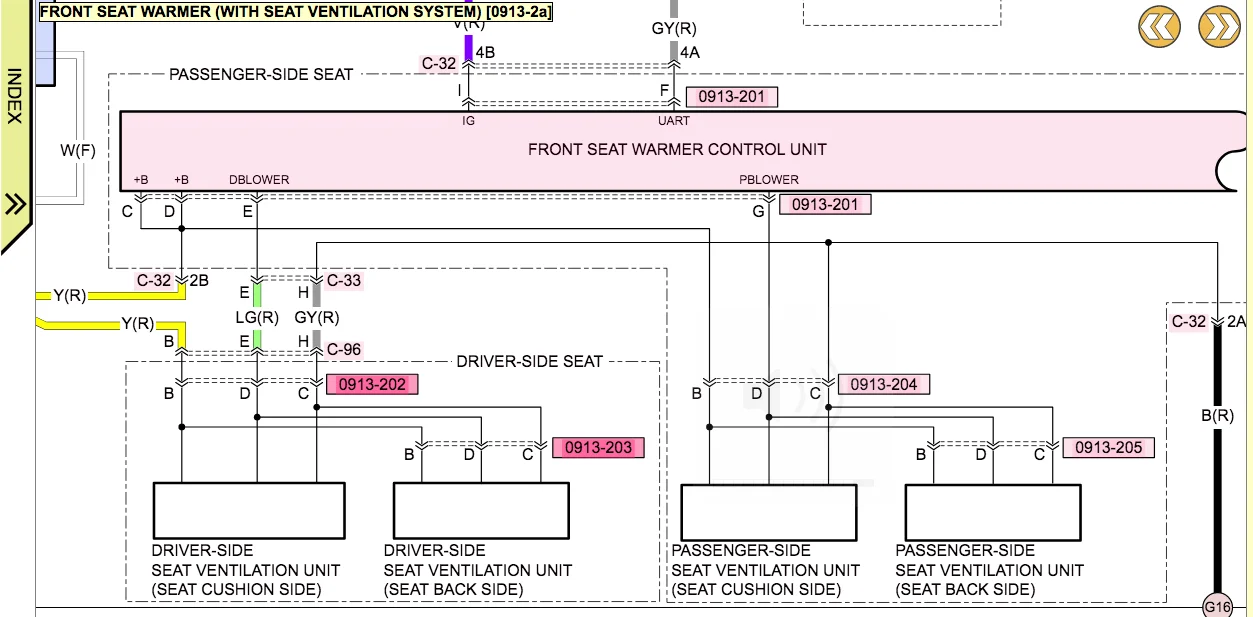

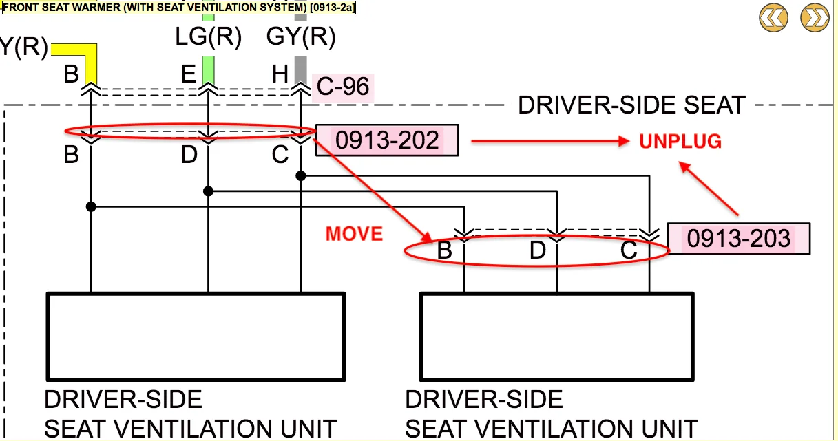

There are two connectors in 2021+ but the way it's wired, unplugging 0913-202 cuts power to the seat back side. Maybe it's possible to unplug both 202 and 203 and move harness to plug directly to the seat back side B,D,C, see picture.
Upvote 0
Thank you MZDCX5, I don't have seat ventilation. I appreciate the time and effort you put into this.. If I decide to continue along this line I think I need to pull the seat and do some trial and error without destroying anything, haha. Thanks again, Tom
