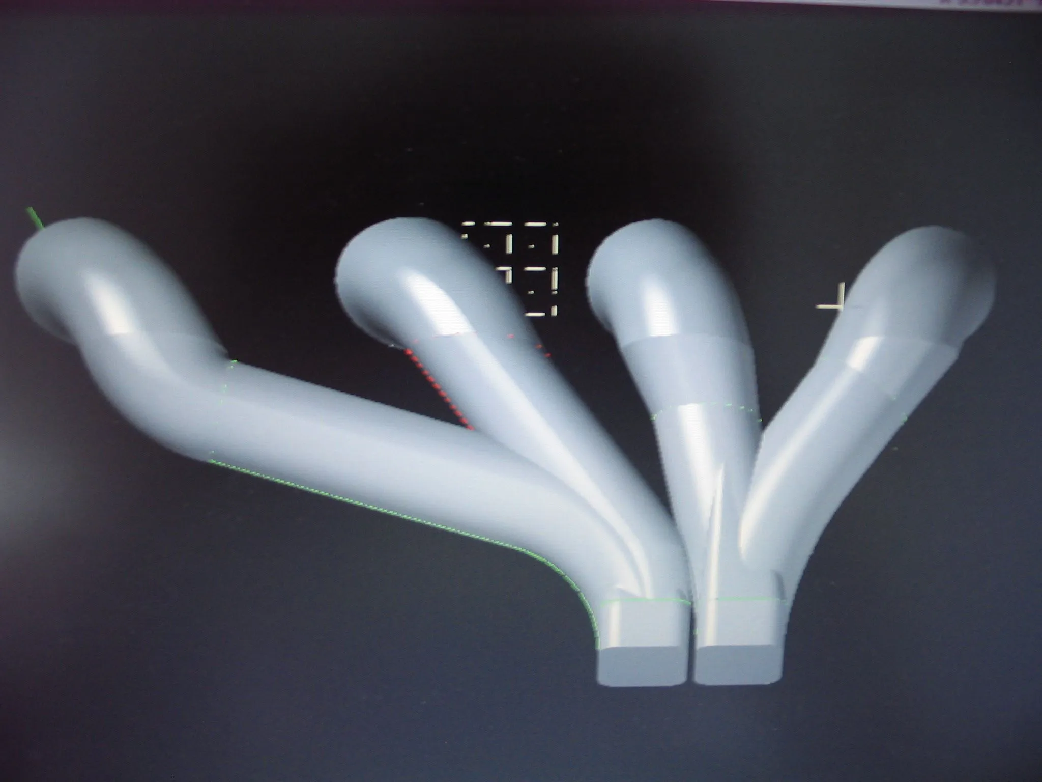

I'm interested in seeing a side by side of the new and previous SteedSpeed manis from the runner side. Or even the disassembled interiors next to one another.
There is a pic with them next to each other.
Passages on this are slightly better because I wasn't restricted to the stock turbo location.
If possible, or even better, the interiors of the runners (a la cross-section).
No biggie, just curious.
Here is how they look on my computer screen. The two pairs of passages on the left and right are divided to the turbo flange.
