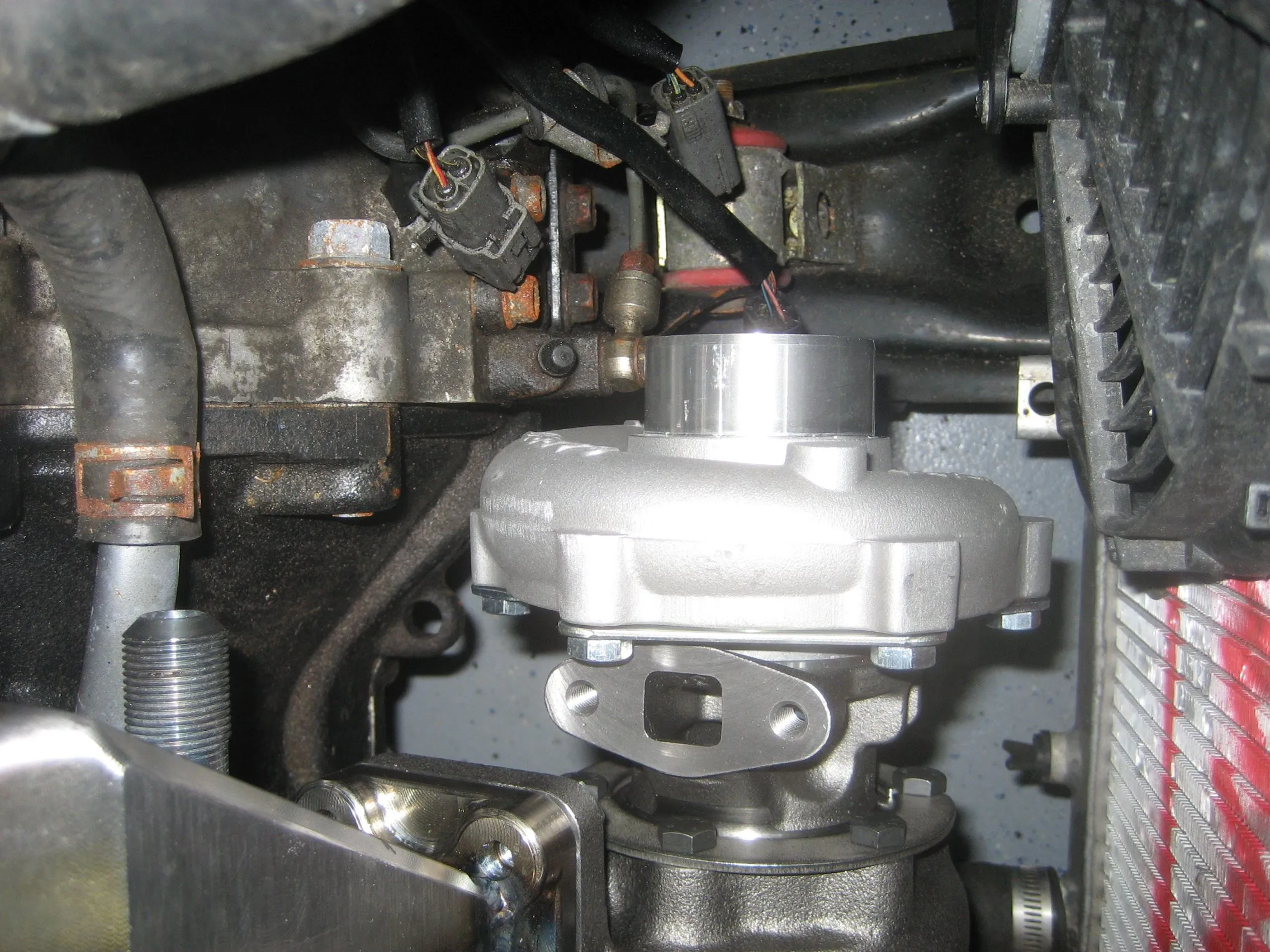

The reason for V band is that the Tial 38mm Vband is way shorter that the old 2 bolt version. I am hoping it will clear the rad etc but if not then a 90 degree adapter will go on there. I'll try and get a good shot of my computer screen so you can see the shape of the passages.

It's a little bigger. Dino sent me a jig to show where he wanted the turbo flange so I just made it to suit that. Turbo is held further away from the block and on an angle. This is just a prototype and the production ones will be slimmed down a little. Passages worked out nice and its going to perform very well.

The manifold was made using a jig that Dino sent me. He positioned a turbo in a car to get the flange location so I'm pretty sure it will clear the rad.
Divided outlet is just to make sure there is no reversion in the manifold. They are simply divided left to right down the middle. I actually made the passages quite small to get it spooling fast. Having an external wastegate takes care of flow at higher rpm.

Dino setup the jig on my car and used a bigger turbo than the one that will be used in the turbo kit.If you take a look at my avatar you can see i have a pwr 2 core rad. and i have a spal fan and everything cleared fine.As soon as we get the manifold well takes pics and give more specs.

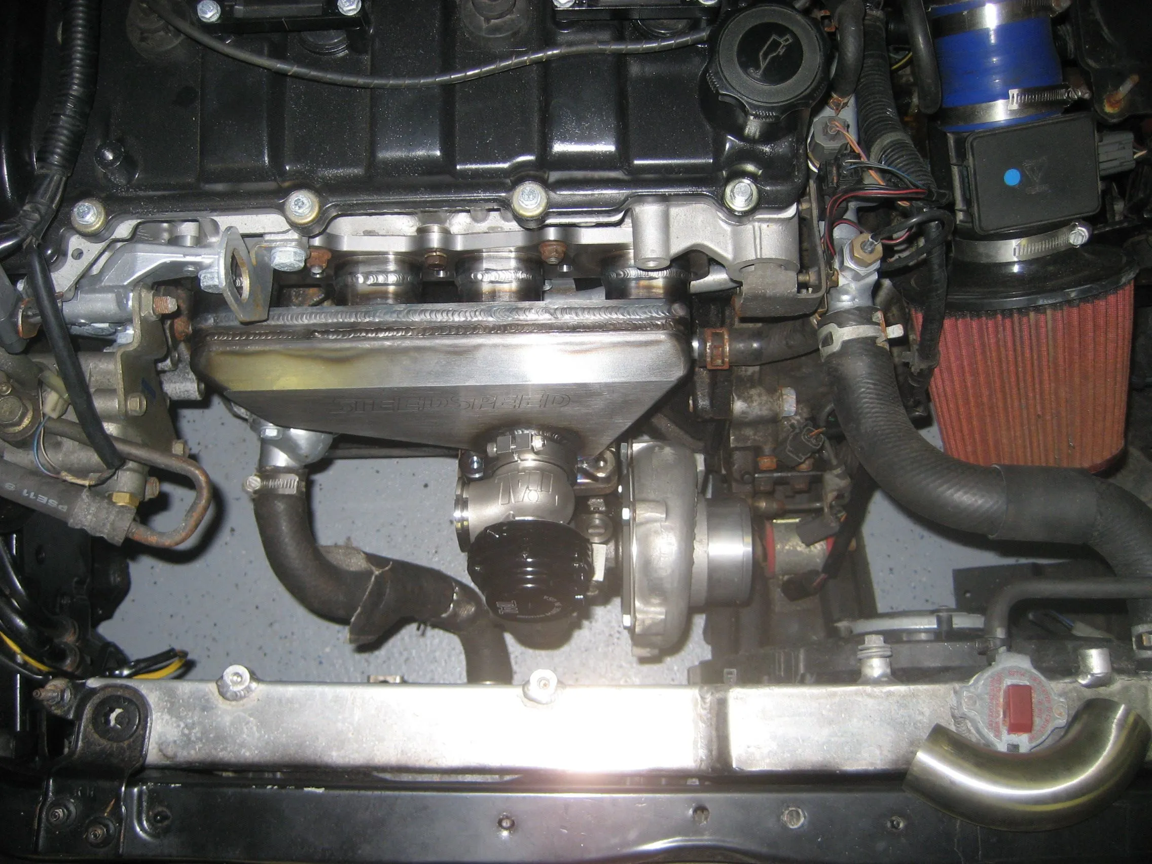

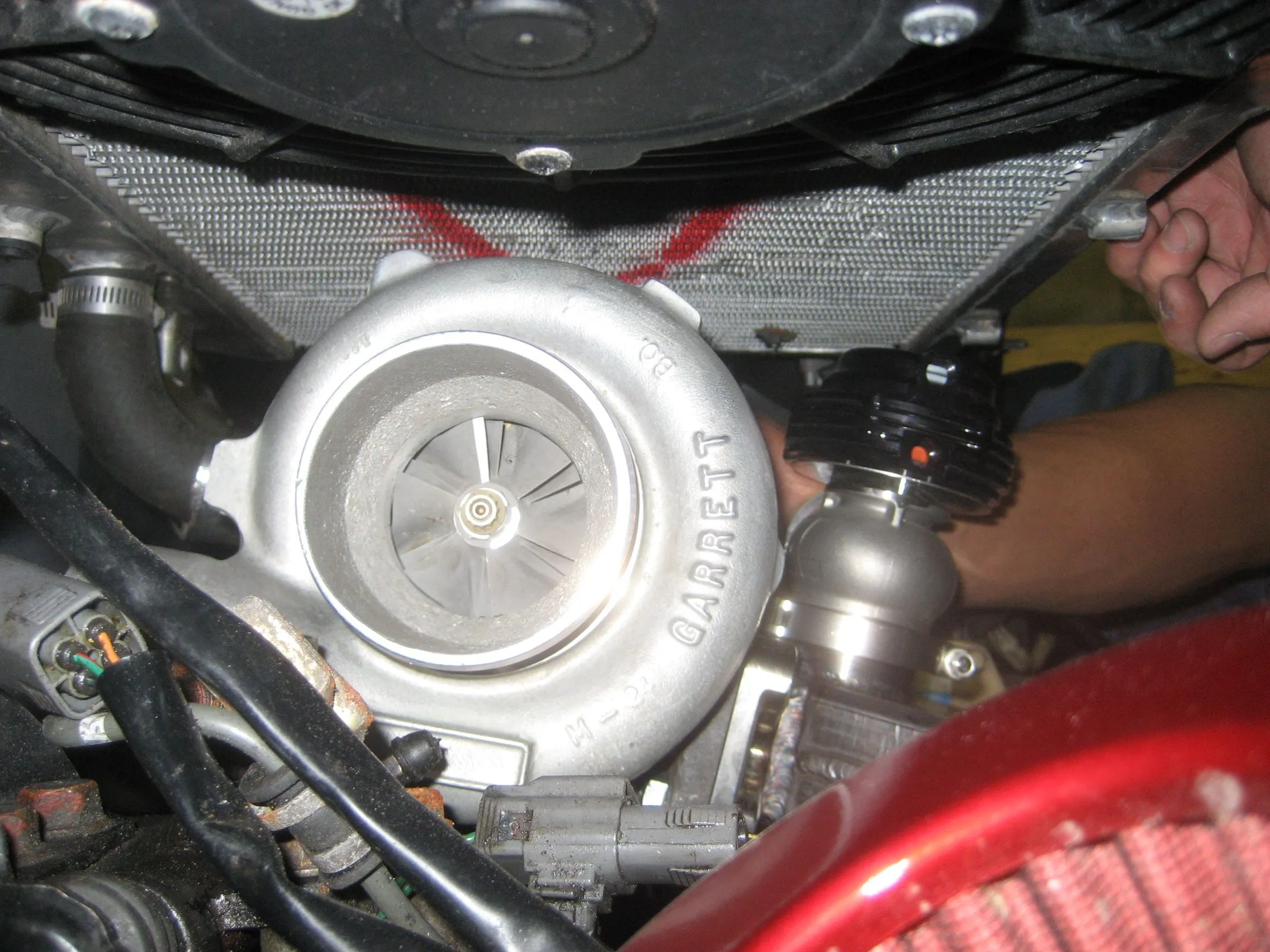

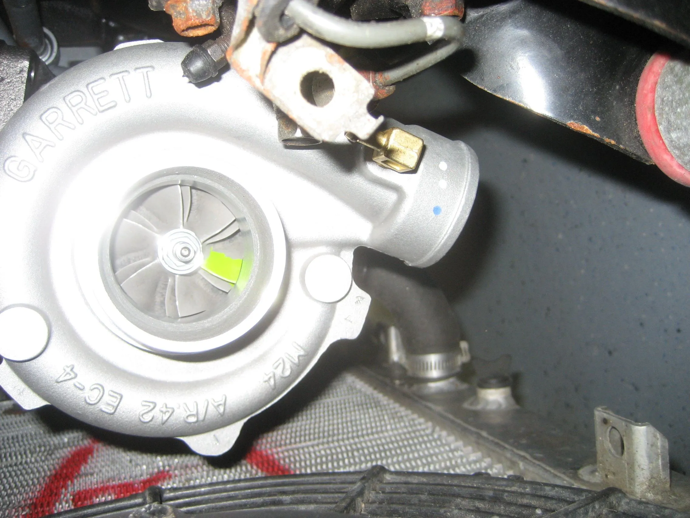

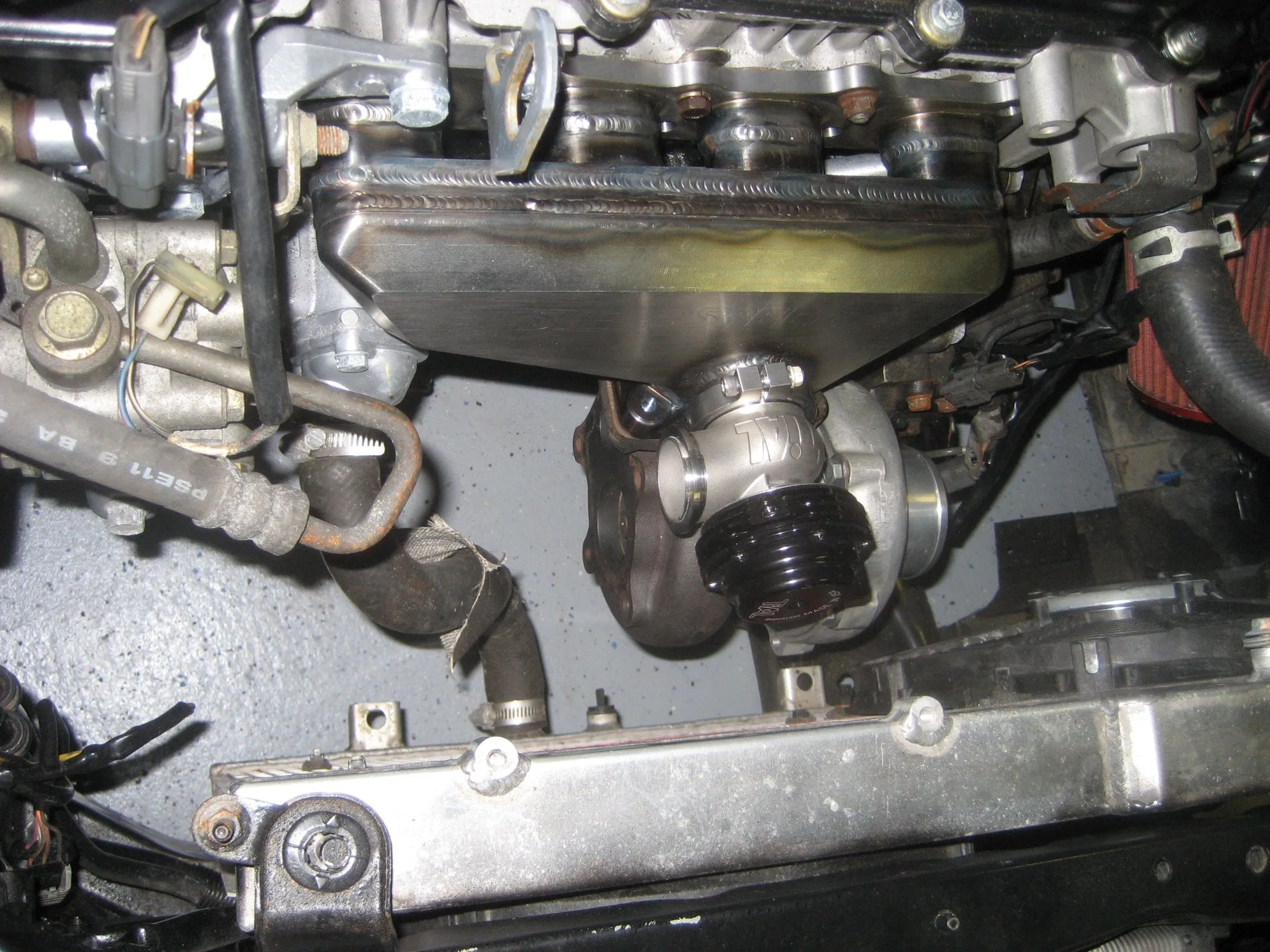

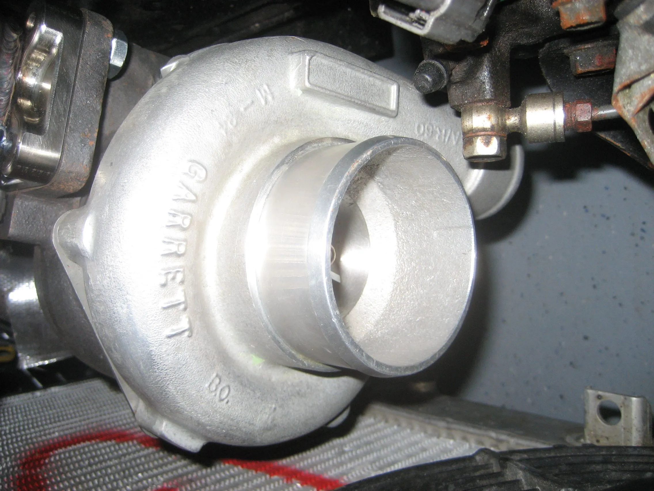

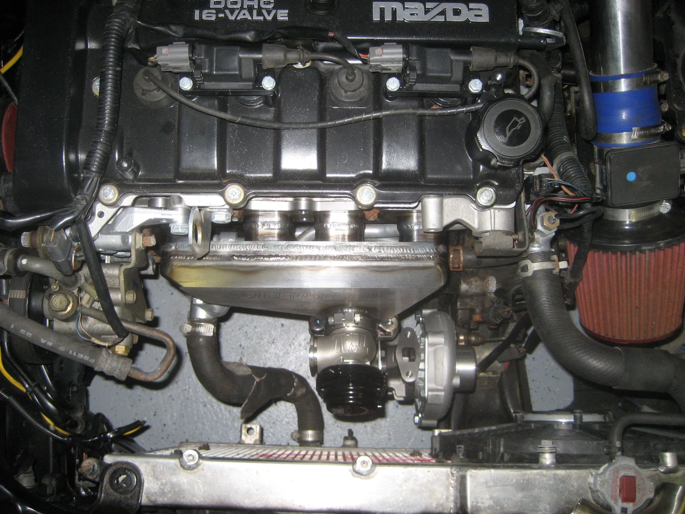

Got the mani last evening and did a quick test fit.
First with the T3:
attachment.php
attachment.php
attachment.php

And then with the 2871R...
The car is running NA right now until the new motor is broken in.The turbokit will fit any 2.0L protege when its completed.
