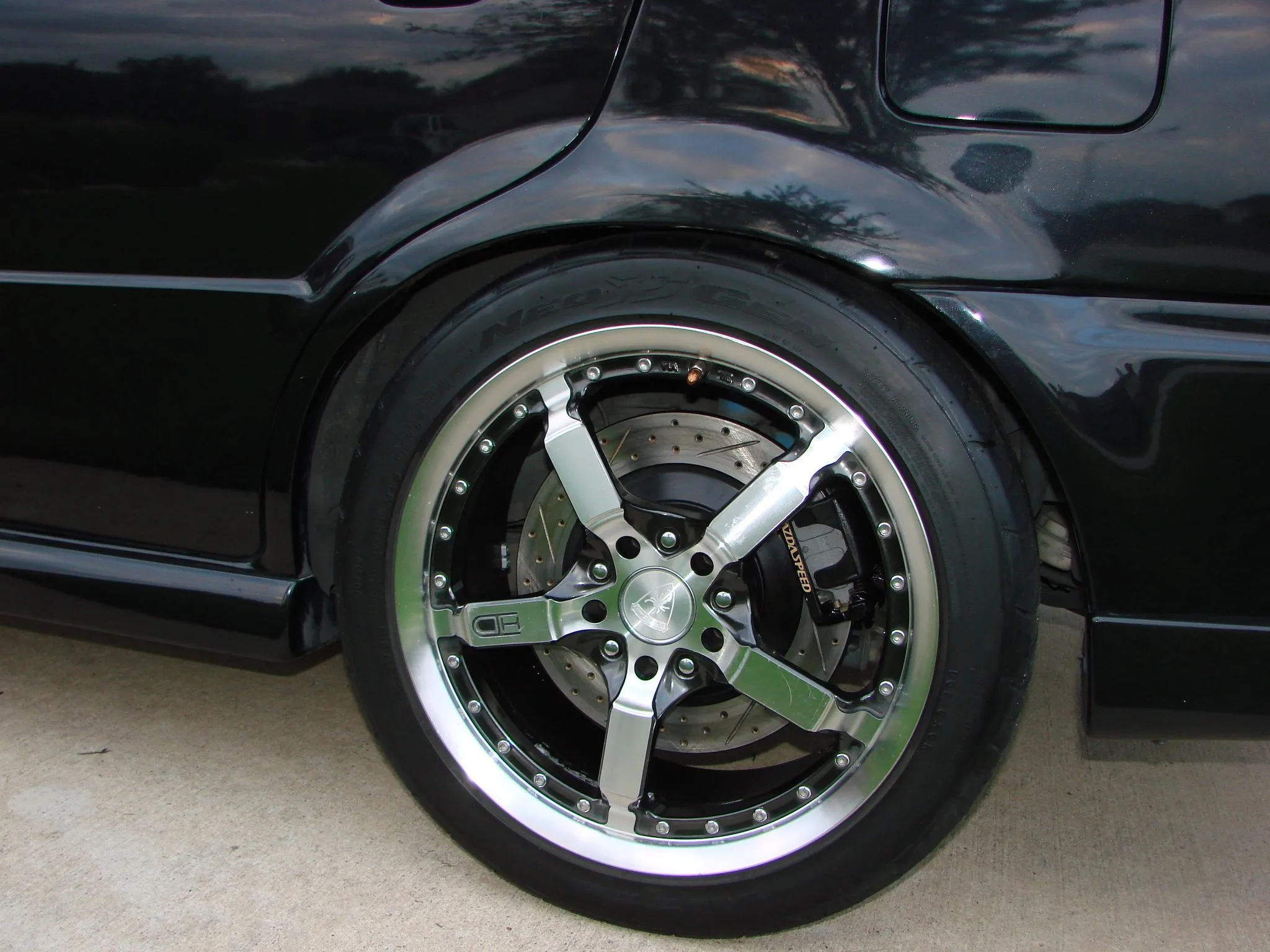

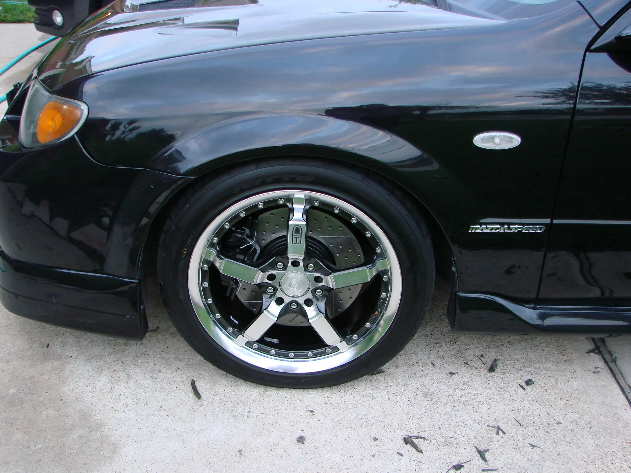

Mazdaspeed Protege with Mazdaspeed 6 BRAKES
Here is my Mazdaspeed Protege with Mazdaspeed 6 Brakes
I love this 4 wheels kit... (cool)
Do you have a price for this 4 wheels kit in this Group buy(brackets & calipers)?? Because i am interested...
Im Highly Interested on that 4 wheel Kit cross drilled and slotted, they look awesome and seems to be lot better than the MSP brakes for real.... does the E-Brake work with this Rear conversion ???????
