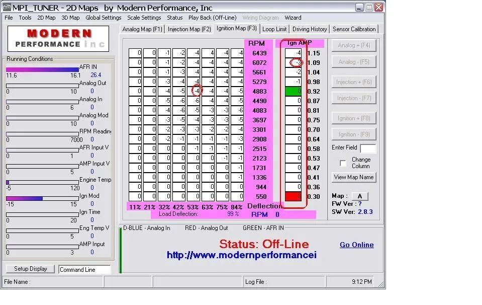

smp3000---here is a shot of what I am talking about on the igniton tab. If you are at the point where the -4 is circled on the map and the point where the -3 is circled on the amp cloumn, then you will have -7 degrees of retard at that point instead of just the -4. That will keep you a bit safe when there is more load on the engine, it will be pulling more timing as the load increases. Got it???

Tim,
Totally understand. I never knew what that side bar was for. Now I do. Right now it's all set at 0 for ignition and all set at 1 for fuel. My timing chart at full throttle going down looks like this: -7,-7,-6,-6,-5... Very similar to Pats.
