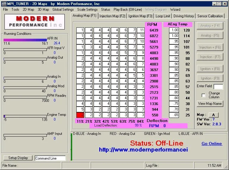

I am down to 1 zero fuel calibration, and I still bog when I hit boost. Not as bad, but I bog. I think it could have something to do with the in-line fuel pump I have installed still, cause Chas is at 4 Zero fuel calibration. I had to put a 5 in my idle square to get it not to run lean at idle. I also notice that my engine coolant temp display in my PDA Dyno went down to 39..lol....when the switch was triggered! I notice a that my J&S is lighting up like a christmas tree when I bog, and hold the gas. If I hold it long enough, I will take off, but still be in the low 10-9 range in my A/F ratios at 7-8 PSI. I have pulled some more timing, and it doesn't light up as much. I will also be turning up the boost a little.
In sumation: It looks like I may have to take that Pierburg In-lin fuel pump out!

1. Analog Fuel Map
2. Ignition Map
3. Playback Log

It still seems like you have to much fuel in the map. You have higher numbers with the newer TM than I do with the old one. Have you went to lower numbers with a higher fuel cal yet? I know you know how do to it, but 4's seem to high compared to what I have.

Linux.
Couple of things.
1. I am going to drop my analog fuel cal again Prob to 3..to get my numbers a little better.
2. Remove the inline fuel pump.
3. In the actual fuel map... 8X16 you idle column..is all messed up. You need to edit them a bit..You wanna have 1 number steady throught the column..this will help with cold starts.
4. Also in the fuel map. The first Row. Should all be zero's b/c it will affect startup. (aka my car took longer to crank)
Not sure why you are detonating while you are runnin so rich? I am confused b/c the same thing is happening with me..The more i lean it out..the more i seem to detonate..and have to pull more timing. I have a total of -10 worth of timing on my ignition map..and still detonating???
Chas

The numbers I have entered are a must to keep me from detonating while not in boost. Pinging while not in boost is what I saw with lower numbers. As I lower the Fuel Zero Calibration, I keep having to richen up the numbers. Where you see 4's I now have 6's, and my Fuel Zero Calibration is now at -1! (eek2)(eek2)
