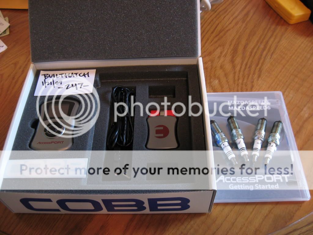

I received this new on 1/16. I flashed the stage2+sf 93 map and stage2+sf 91 map and evidently my particular car needs a fuel pump upgrade to run those maps. i then unmarried the AP and re-installed my factory map.
i told myself i was not going to get that involved with this car and i have to stop myself before i end up with a fully built ms3.
The plugs have about 200 miles on them. They are gapped to .028. They are the NGK IX iridium heat range 7 plugs and normally go for $40 a set.
I will sell the package for 550 + shipping firm. i have absolutely no use for the plugs without something to make me run additional boost, so i won't split the two up as they are meant for each other.
