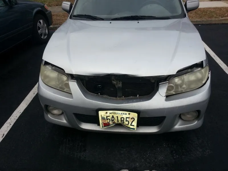

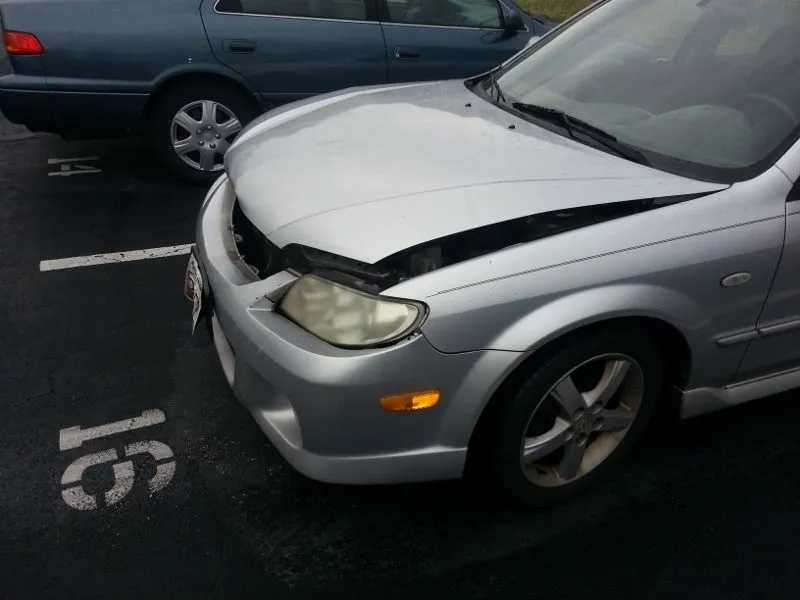

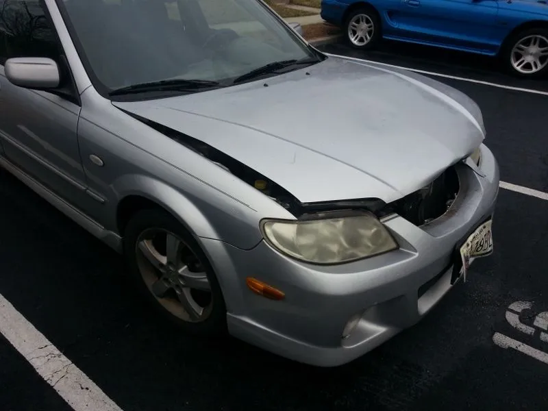

Anyway, here's some pics of the damage. Thanks for all your help. Any more advice is always welcome.
20141228_084718 (800x600).webp20141228_084726 (800x600).webp20141228_084734 (800x600).webp
I don't see anything that couldn't be repaired fairly easy in those pics. Just some parts to get and put on.
