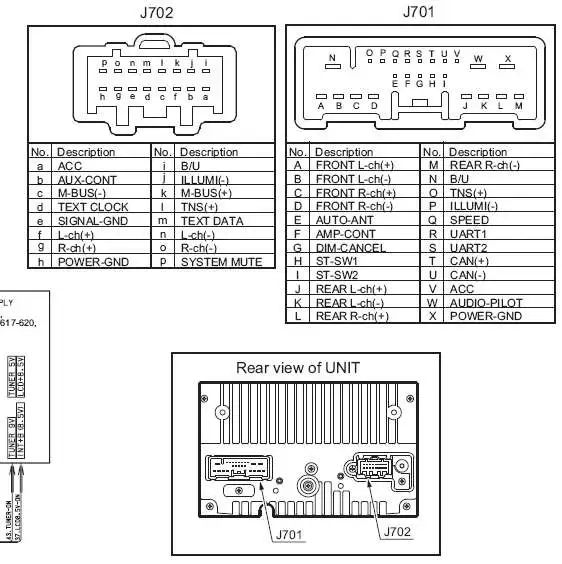

This looks like this connector. You'll probably have to build your own adapter, try searching on AliExpress for something like 16 pin Mazda stereo adapter or so.

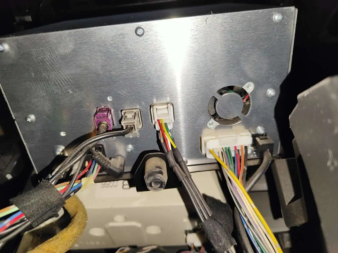

sorry if I don't write well in English, but I live in Italy 😅 in any case yes that's the problem, the power cable that they give together with the android car radio has a different connection from my original one. I was able to find a cable that has the same attack luckily, yes ali express, when it arrives, I'll see if everything works. Unfortunately I'm not very familiar with wiring harnesses on cars.

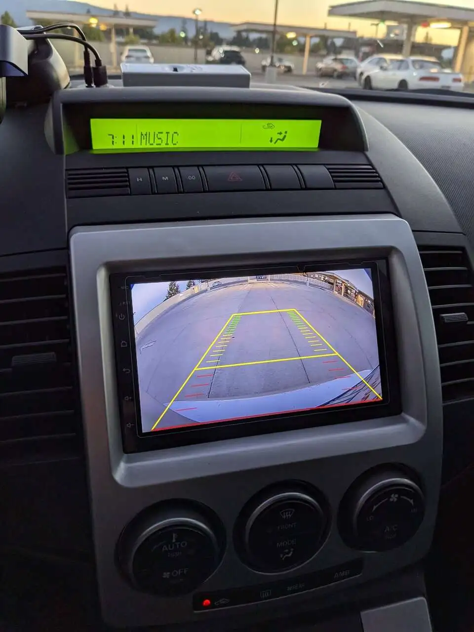

The manufacturer claims this camera angle is 160 degrees. Attached is the picture from the head unit. The camera is installed under the license place light using this fixture.
Parking lines (adjustable by software, by the way) are roughly aligned along the outer edges of the tires. I used some measuring tape, chalk, and long pavement grooves to adjust it, this is the result of the adjustment.
