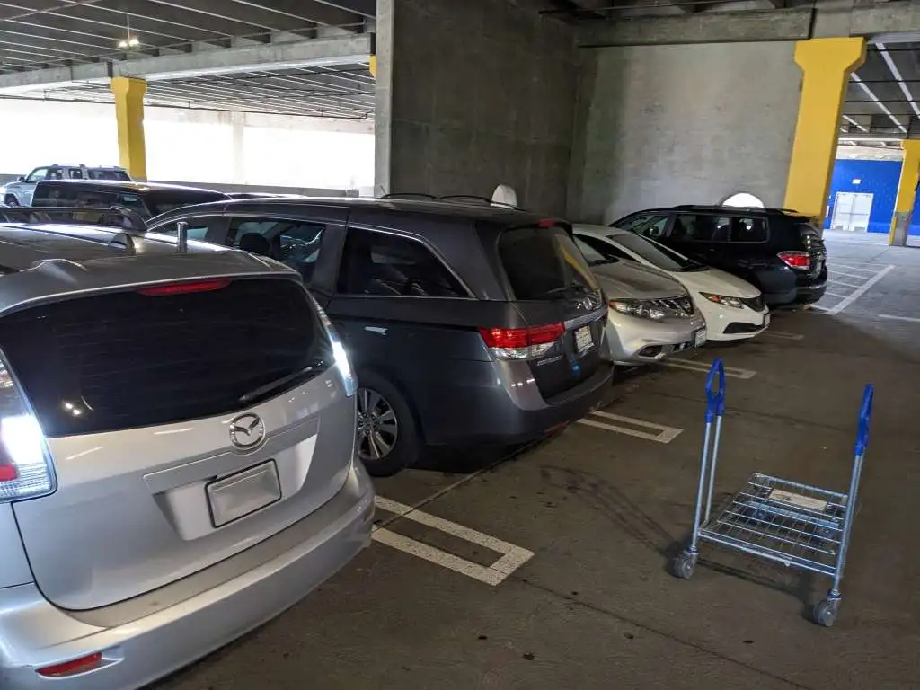

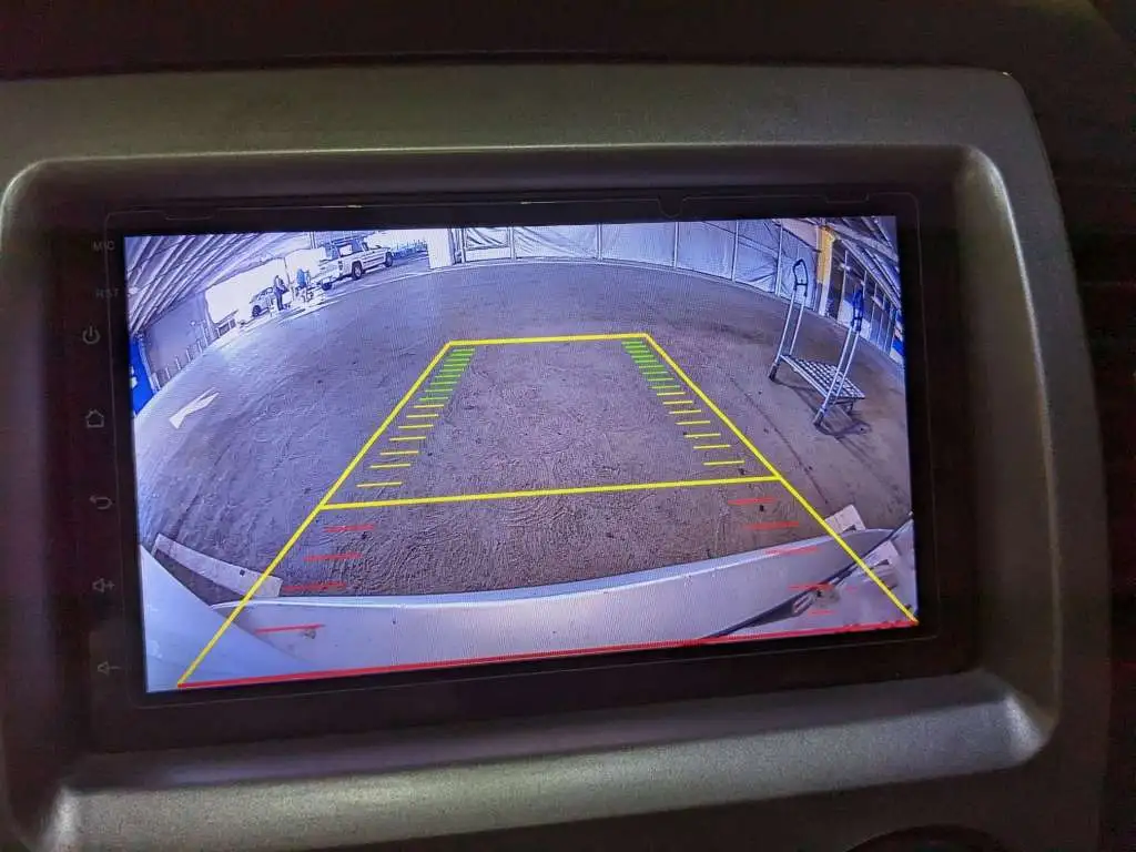

The manufacturer claims this camera angle is 160 degrees. Attached is the picture from the head unit. The camera is installed under the license place light using this fixture.
Parking lines (adjustable by software, by the way) are roughly aligned along the outer edges of the tires. I used some measuring tape, chalk, and long pavement grooves to adjust it, this is the result of the adjustment.

If you want, I can take some pictures while driving out of the parking lot. Camera angles are really good, it's like I'm able to look around the corner with it.
Thanks and yes, post a few pics if you don't mind.
Your camera uses a Sony lens and judging by the curve of the far-away lines in the pic, there's definitely a more pronounce fisheye view even though advertise as 160* ($40), than my as advertised 170* (but $8), which has more of a straight view. Was hoping for something cheaper but for the benefit, may consider it.

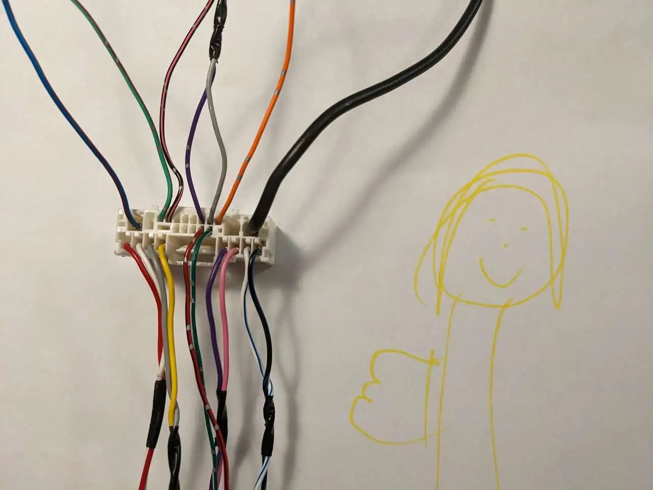

Hello, check this out: 2013 Mazda 5 Stereo Wiring Diagrams
Perhaps, you need to start identifying the wires and building your own harness. I also happen to have an original Mazda 5 wiring harness (joke about a box of cables here), see attached.
This + the schematics I posted previously will help you identify which wire is which.

I really thank you for the help. I managed to find a cable that works as an adapter for my original power cable to attach to the android car stereo. when it arrives I will try to connect everything and see if it works.

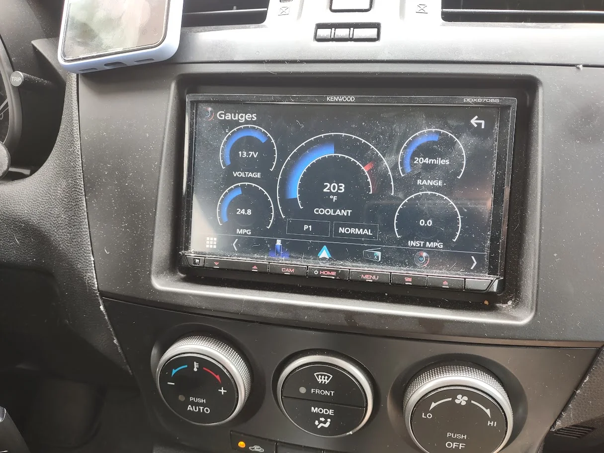

On a side note, I'd like to use this opportunity to flex 9" android head unit, see attachments. Sharing my experience: if you ever go aliexpress way, better stick with popular brands that have community, firmware support, etc. I purchased "otojeta", which is a rebranded "idoing" and I'm quite unhappy with overheating, lack of mounting hardware, minimal support and crippled canbus adapter.
Think about aliexpress android units more like as of "DIY kits" than a product.
On a positive note: I would definitely recommend this particular https://www.amazon.com (commissions earned). This is not my first installation and these are cheap, they come with an easy to fish cable (round barrel connector) and the picture quality is awesome. Also, you can disable parking lines, which I did, as my head unit has adjustable parking lines.

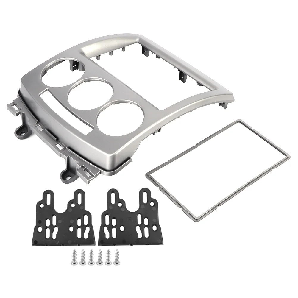

hi, have you mounted the original mask for the android car radio or was it already together? Thank you

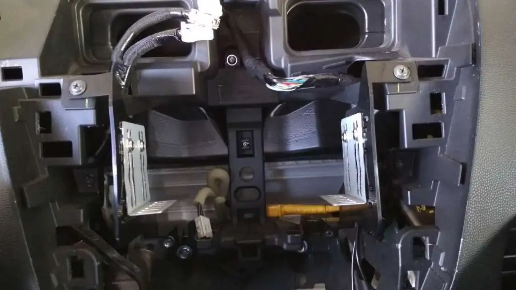

Hello, I bought it separately and put everything together by myself. I reused metal mounting bracket from the original stereo, because plastic brackets that came with this face were no good.
Also, for the record, screen protective glass is from Nintendo switch.
but this grille is for mazda 5 first edition though, is your car not second edition?
Correct, this is the first edition.
I also have 2nd gen Mazda, mentioned here. The black panel I got came with the Android stereo. It's kind of "standard" across Chinese brands. It's a 9" trapezoid shape. You can find it everywhere, search for "Mazda 5 android fascia" or "Mazda 5 android panel", for example here.
The one I purchased with the stereo was crappy, though, with the plastic bracket. I got a metal bracket from another radio I installed previously. You can search for "2 din mounting bracket" or buy it here, for example. The problem was that that particular radio was that it was neither "2 din fat" nor "2 din tablet", but rather a "2 din tablet with slim 1 din horizontal body". That's why I had to craft such a contraption as see attached.

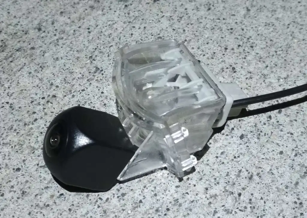

The reverse camera, by the way, is available with a clip-on bracket, which easily clips on the license plate lamp, see attached. I don't like it, I don't recommend it, I drilled the plastic trim (see original post) and used such a camera (not this particular one, it's an example of camera shape) for discreet installation. It's not wide-angle, though, the wife is unhappy about that. I'll probably do some research this summer and upgrade it.

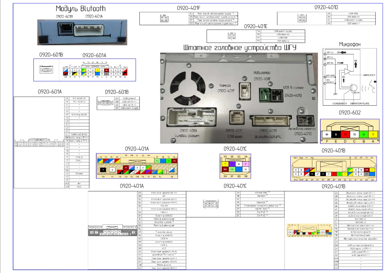

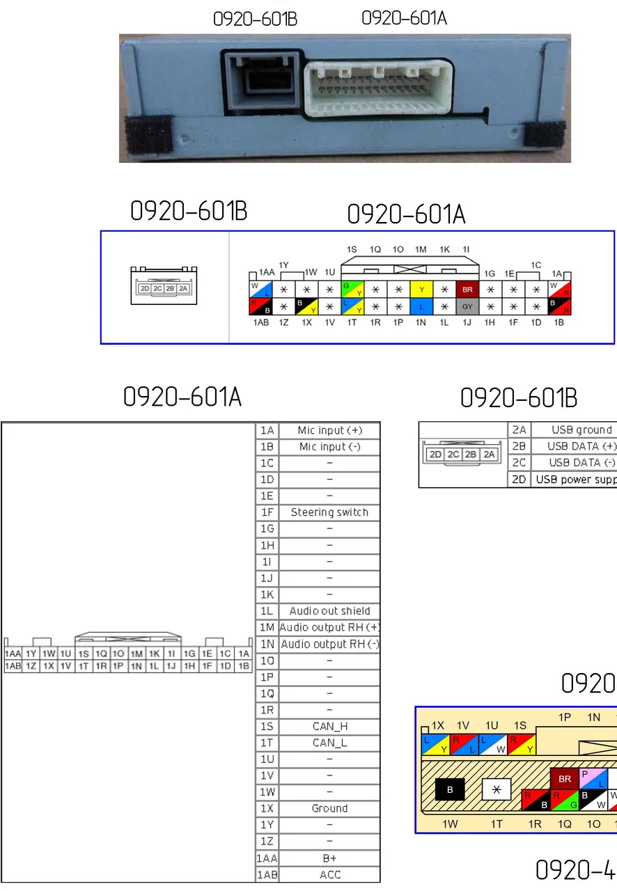

Pickup, hang up, talk steering wheel buttons are controlled by 1F pin on 0920-601A connector (big one on the bluetooth module).
If you're using generic android stereo with SW1 and SW2, you should connect 1F of 0920-601A to SW2 on android stereo via 330 ohm resistor. And SW1 goes to 1N of 0920-401A (main radio connector).
If some canbox controller is used (generic chinese, for example), 1F pin on 0920-601A --> pin5 of canbox, 1N of 0920-401A --> pin15 of canbox.
I've attached the schematics which I used for reference when I was connecting android stereo with canbox (although, all buttons are connected via SW1/SW2 in my case, not canbox).
Absolutely everything works as intended, including overlay displaying which door is currently open.
Also, you can definitely repurpose existing BT module by ripping out the connector and reusing it for a cleaner installation. I screwed it to a piece of plastic and soldered everything neatly. This BT connector is a perfect place to connect sleepy Pi / any sort of additional computer one want to use. This connector has ACC+, BAT, GND, CAN-H, CAN-L, I wish I had time for this.
