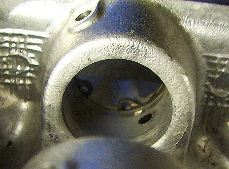

Igdrasil,
Thanks for the infos. How much did it cost you to have the machine work ? I just need a reference for pricing so that I know if I'm overcharged when I talk to my machine shop. Thanks again !
turboboy said:
Igdrasil,
hmmm...i dont remember, close to $120. ill get back to you...

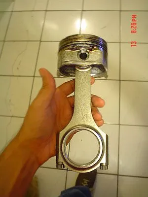

turboboy said:
Just wondering how you go about modifying the stock piston to use with forged rods ? I know Hiboost uses this combo but no one has ever mentioned how its done. With forged piston, I just don't want to deal with piston slap on cold morning startup and excessive oil usage. Thanks !
Find the correct pin for both piston and rod (or use the ones from arias or cp sells from his forged set) and modify the piston for it.
Check the pic
Igdrasil
Thanks for all your help, i know what needs to be done now. But I just found out that the Oliver billet rods i bought are the long one so I have to get the CP pistons. I guess I'll sell the Oliver and get Pauter with stock piston !!!
