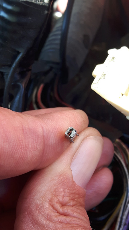

I'm thinking that when the problem originally started, a probe was stuck into the ECU connector on the orange wire.
A bit like this... (this is my fuse box connector though )
This is before I plugged the probe into my wire connector tab.
This is after I jammed my probe in there.
I'll bet it no longer makes contact with the pin.

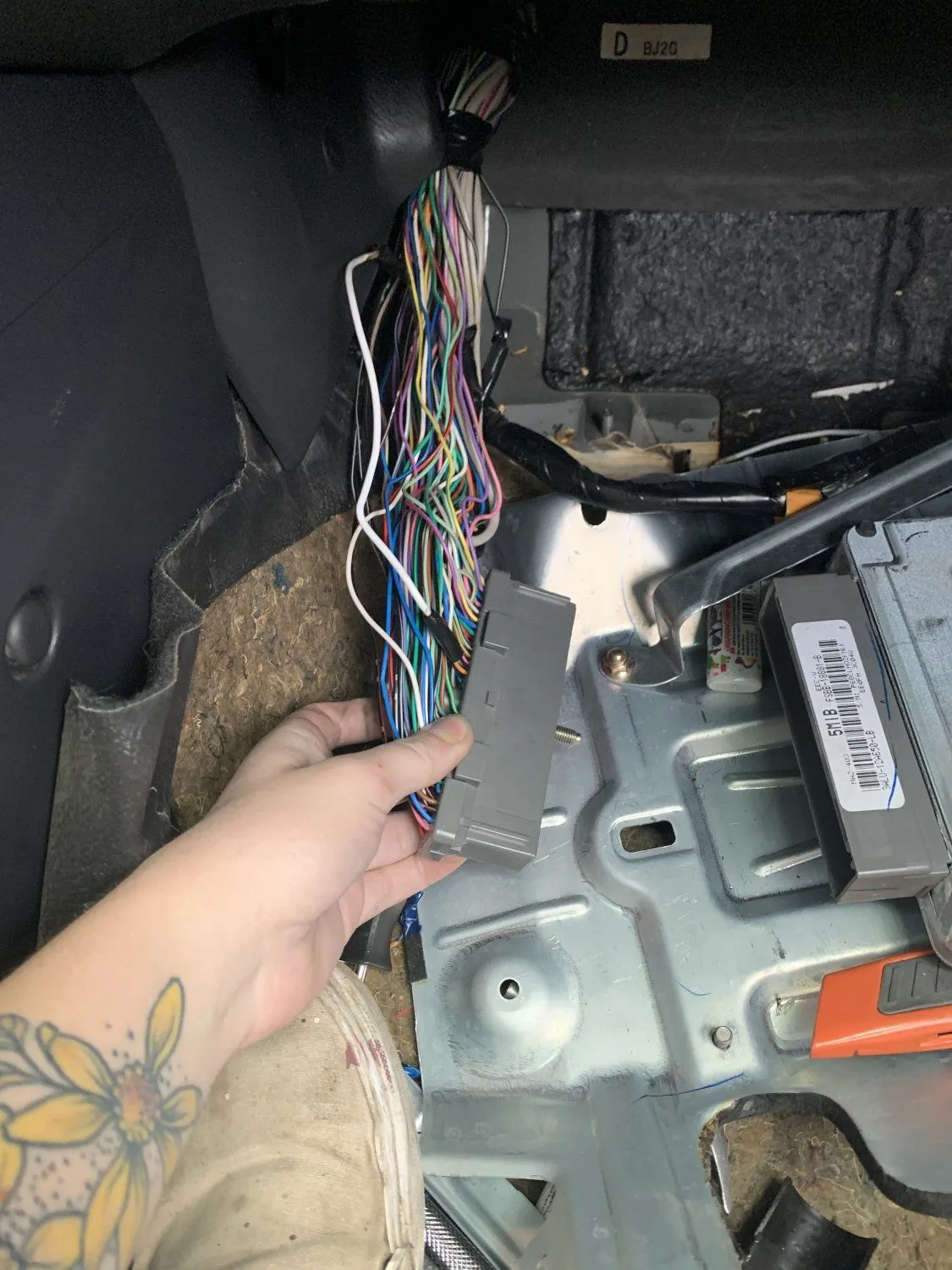

should I just stick the white wire into an open spot on the ECU and if no how to get it into the spot? i’m assuming it’s not as simple as just sticking it in and that’s it.

I can find a wire that can be removed from your ECU connector.
That won't make good contact and it will fall out.
A proper clip will lock in.
The white wire (which was originally orange) needs to connect to pin number 91 on the ECU.
That metal tab can be removed from the connector and replaced with an unused wire/tab/connector from elsewhere in the connector.
Pins number 81, 82, and 84 are apparently unused by the ECU and can be removed from the connector then plugged into pin # 91 then connected to your white wire.

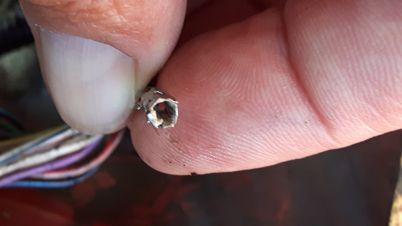

This is a wire removed from a connector.
Your connector/tab may have a slightly different shape or size because it is from a different connector.

I got it out!
I tried to put it into an open slot and still nothing. I tried to go to the slots you had suggested but they all had wires in them.
Should i remove the orange wire from the connector and put the white wire in?

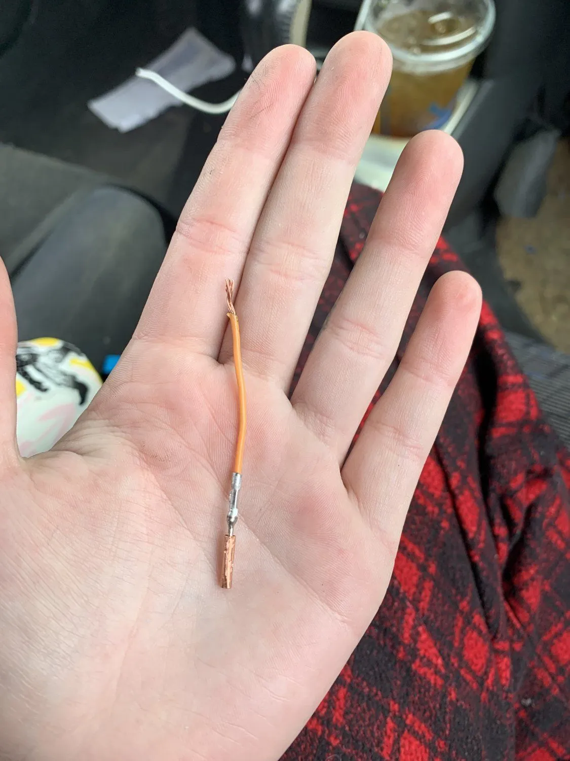

also how important is it that the wire is the same size? I couldn’t find small enough, i’m thinking the orange wire is 24guage and i got 18.

That orange wire needs to connect to pin #91.
It appears to be in good shape so it may be making proper contact with the pin on the ECU.
Being as you've got it out, connect an ohmmeter to the metal clip and with a big long wire connected to the ohm meter, probe the other probe of the ohmmeter to the orange wire of your temp sensor wire or its connector to check for continuity.
That orange wire is probably broken or disconnected somewhere along its length.
