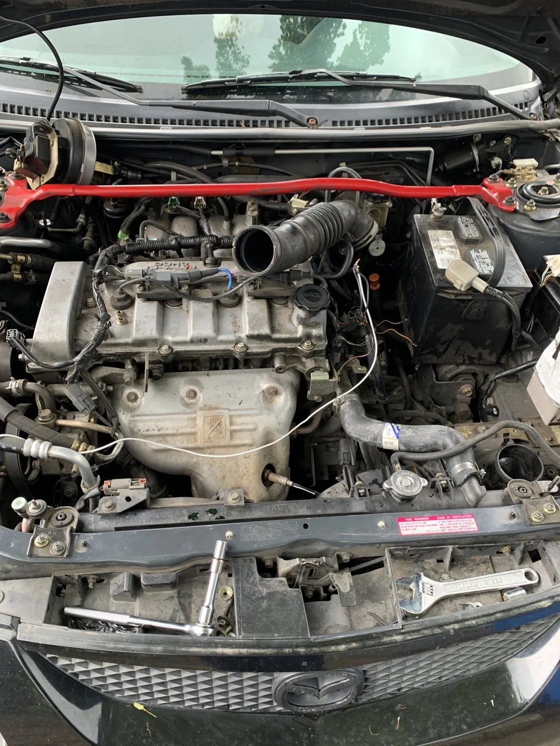

I connected the white wire to the sensor and the ECU just to see if it would change anything before i replaced the whole wire. and that still didn’t do anything.
So the white wire is going from the orange wire of the sensor to pin #91 at the ECU?
And you hooked your battery up?
And your ECU connector is plugged in to the ECU?
yes my battery is hooked up

Damn...
Are you sure you spliced into the orange wire?
I guess the sensor itself has black wires until it gets to the connector?
Try disconnecting the half of the wire that you spliced into that leads into the harness so that the white wire only goes from the ECU to the orange wire of the sensor.
Perhaps the orange wire is shorted to ground somewhere and that's messing things up?
So, the white wire going straight from pin #91 to the orange wire that has been cut out of the circuit.
(That won't help the other sensors but see if you can get the temp gauge working)
The only other thing I can think of is a bad connection on pin #91 or a bad ECU.
Check the pin on the ECU that goes to the orange wire to see if it's bent, broken, dirty, loose or something.
You might get lucky and all the sensors can feed through that wire.
It depends on where the "burnt" wire is and if all the orange wires are on the same side of the burnt spot.
Try wiggling the orange wire at the ECU while watching the gauge.
I think your still on the right track.
Maybe try removing that orange wire from the connector again and plug it directly onto the pin of the ECU to see if its snug or sloppy.
