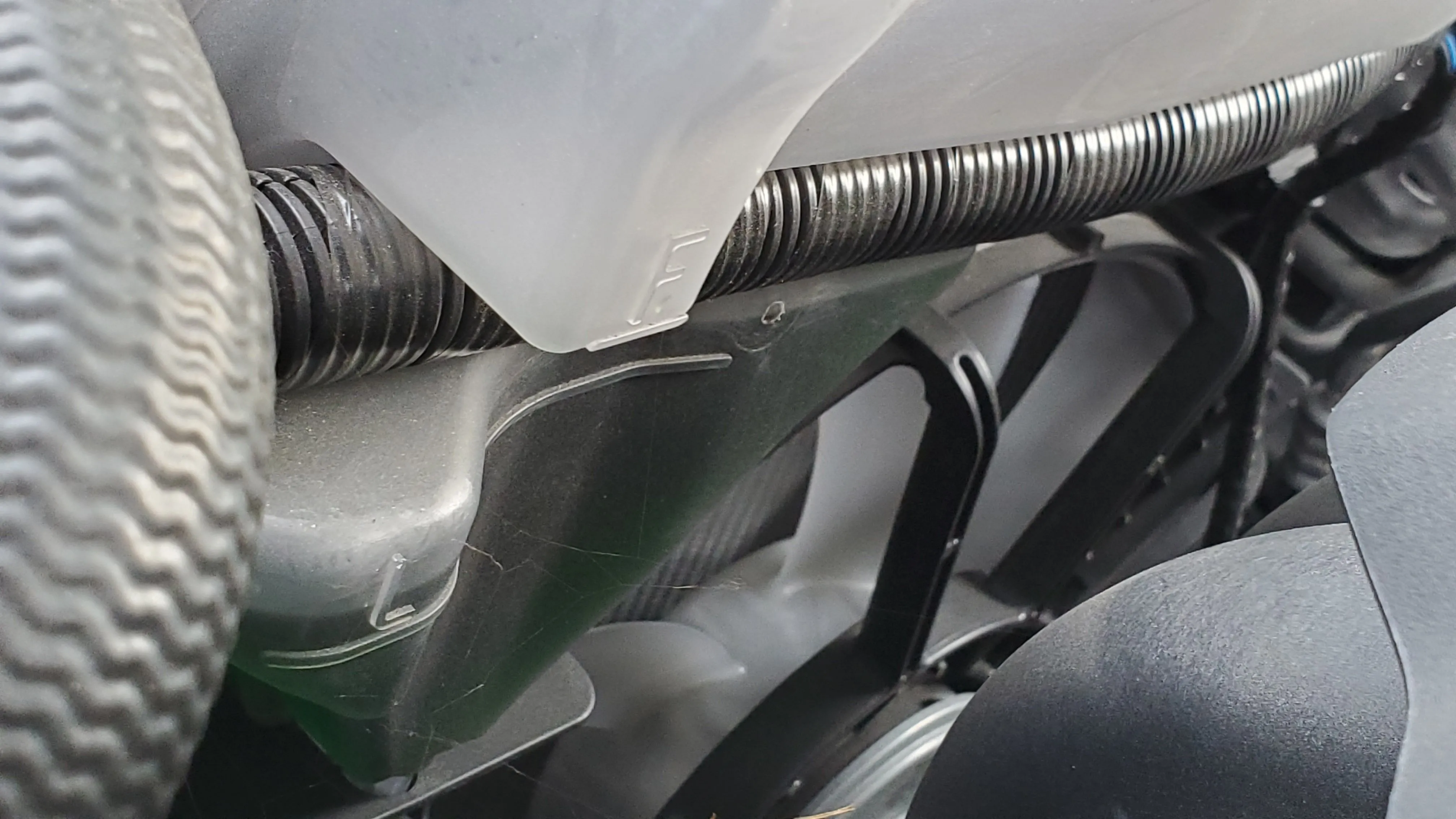

may i have your opinion on the engine coolant antifreeze level should be at, please.
a jpg is attached.

That level is fine. Top it off when it*s at the L or below.
I agree. OP should use (Mazda) FL-22 coolant and fill to the *F* mark when the engine is cold.

Actually, when the engine is cold, the coolant level should be at or just above "L." Remember, the coolant level rises as the engine warms up. When the engine is warm, the level should be at or just below "F."

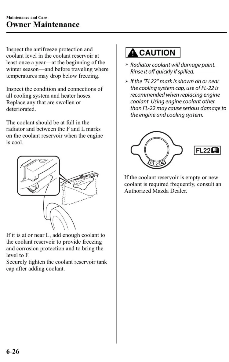

OP can check his coolant level and the level should stay relatively the same when that engine is cold or warm. In other words, his coolant level will still be near the L mark even if the engine is warm. And the Owners Manual speaks for itself that you should check the coolant level when the engine is cool, and bring the coolant level to F mark when its near L.

Mine came with the fluid just above the L from the factory. Thats within spec. Left it that way for 5 years until it dipped to the L. Topped it off to F. Just saying I wouldnt lose sleep over it.
