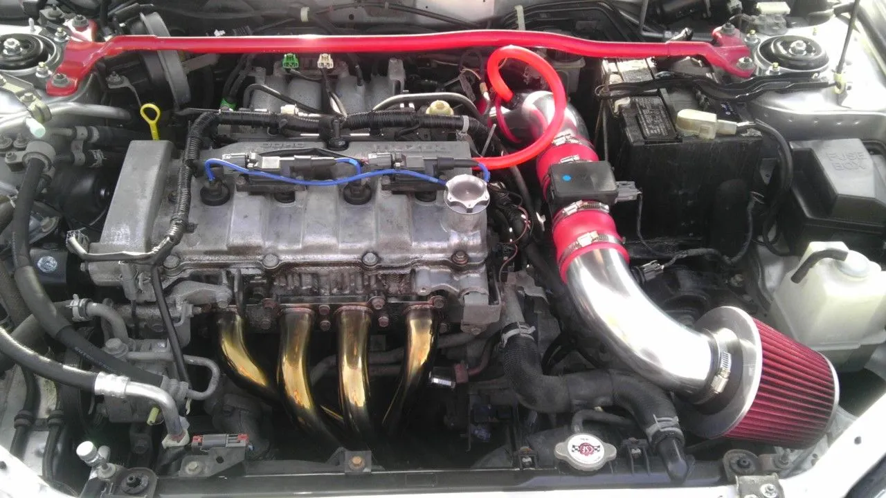

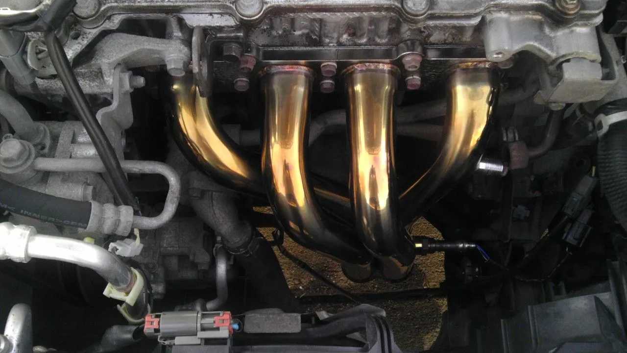

So finally got my parts in a couple days ago(had to wait much longer than usual because of the hurricane) and just had some free time today (and still ran out of light) to get the gasket installed on the midpipe, I didn't take pictures but it sure as heck took care of that stupid ricer noise! However, I was unable to fix the spring bolt situation... I don't have access to a large enough drill bit to drill the holes on the midpipe large enough to fit the bolt that needs to go though. BUT the gasket fit in fine and it tightened down perfectly with just the one good spring bolt and it has held up just fine since I've done that back when I started this thing.
So in essence, exhaust leak is gone!! I also did an oil change while I was under there: Castrol Syntec (fully synthetic) 5w-30, K&N oil filter. I was about to go on 6000 miles since the first oil change which was back when I got this baby, although I've had to had a bit of oil to it every once in a while but not too much, but anyway I feel better about having all new fresh oil in :)
Next big job will probably be the motor mounts... I'm getting tired of all this rattling and lurching from the engine bay when I step on it. I will start looking for mounts! I found $20 ones on Rockauto.com, are those worth getting? Should I look at a junkyard? or is OEM best bet...? (i hope not because I don't have near enough money for those....)

I just went thru the ordeal myself... the bolts wouldn't go thru and two hours of head scratching went by.... until I just pulled the whole exhaust forward and it lined up pretty much as perfect as an ebay header would do. Take care of the mount situation asap... I got a bad rear mount and I could sincerely swear that that header is warping towards and into my crank. As I now have a partially crushed crank corner... before it barely cleared it, but it used to. Gotta get me a better racing header because I'm spending in all the "exotic" parts and an ebay header that could give me problems does not fit the equation.
I ordered corksport mount inserts to see if they get rid of the shimming of that engine. I'l tell you if they're good.. they were like 55 bucks or so
As for exhaust note, I'm completely stock, so, I just got a bit more pick up low to mid range... I'm still dealing with that dreadfully restrictive stock cat... you can just feel the better flow just battling to go thru it. Top end improved slightly but it's easier to drive, as you can cruise really down low in rpm
Take some pictures of that cause I'm pretty sure the exhaust goes no where near the crank pulley
Look at my pic of the angle of the OBX egr fitting on the header and the angle of the o2 sensor below it. It appears by your pics that the angles are reversed on the 2 and that is why your egr pipe will not line up. The egr fitting should come off the header parallel with the ground when the header is in place, not at any angle - straight accross even with top of motor and straight accross in line with front of motor.
