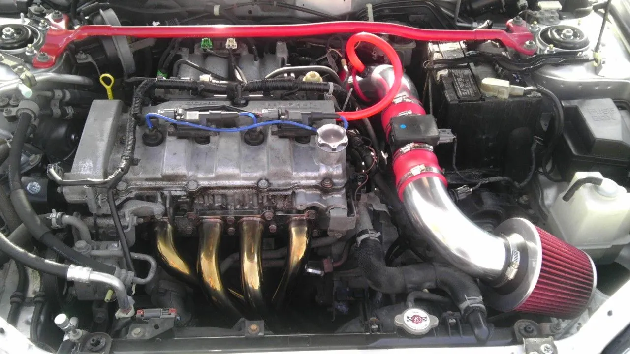

OK! soo I received my ebay (obx style) header and intake kit today. I already put the intake on, and it has a more noticeable grunt when you hit the throttle, however, it is pushed up against the brake fluid reservoir and I can feel it rumble and vibrate through the pedals inside the car. It scared me at first because I thought something had broken (you can also feel it as you start up the car: a harsh sounding shudder especially through the pedals though) other than that I think it's ok so far.

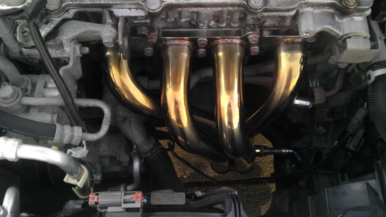

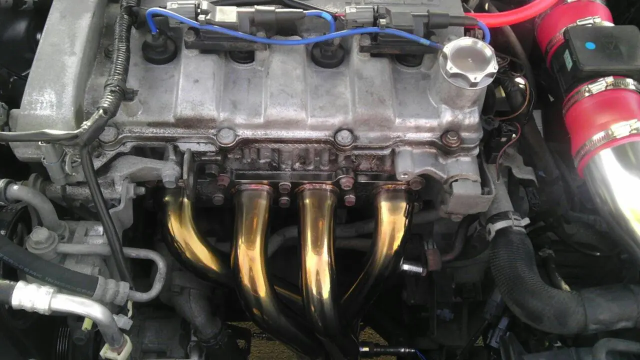

ok, so I have it installed but i'm 100% sure there is an exhaust leak as it has the sound you guys are describing and is obnoxiously loud, especially with your foot down in it and I think it's right at the spring bolts and here is a pic (it actually turned gold after heating up! is that normal for this? I cleaned it alright before installing, and after installing right before I started it up):
and here is what went down:
so after spending all morning messing with this thing (bruises and bleeding skin to prove it) I finally got the stock exhaust manifold off and realized just how very heavy that thing is! I didn't realize the weight savings. anyway, it was a fight the whole way through. anyway....
Just to be sure, I shot a tiny bit of PB blaster on the manifold bolts and a more hefty amount on the spring bolts (they were pretty rusted) and i let those sit till I could get the manifold bolts off and other things out of the way. Ended up having to fight this bracket holding the mid section of the stock mani on, so after removing that annoying bracket (first taking just the bolt off from the side thinking I could just slide the mani out from the side, that didn't work, so i had to go underneath and take out the entire bracket), mani bolts i went to work on the spring bolts. The one on the left side wasn't too difficult, I broke that loose by straddling the passenger side tire for leverage and using my foot to push the wrench and it came off in 3 pieces: the spring, nut, and washer. (i'm sure this was an interesting site: a guy holding onto dear life to a tire with a strained look on his face followed by an "ahhhh..." as the bolt clicked free and certain precious goods were crushed against the tire side wall..........). the other one 'seemed' to come off with little trouble too, untill i realized that on the second one (the right one) the entire stud came out, so I was holding 4 pieces: the whole stud, the spring, nut, and washer. At first I cursed the fact of rust existing, that was then followed by the realization of a possibly ruined day. I'm not sure if it's supposed to come completely off like that as nothing actually looked broken or stripped or anything, but it definitely seemed wrong. But back to this later...
I moved on to getting the rest of the stock parts out. I started to fight with the 6 nuts holding the top part of the mani onto the pre-cat. Once again they 'seemed' to come out just fine after cracking loose, but after taking off the top part i realized the gasket was in two pieces and i'm not sure if it was me that broke it or it was already in bad shape. So now I can pull out the rest of the assembly by just fishing it through the bottom. Yay! stock parts off and brand new shiny header to go in, I noticed the header gasket mating surface was dirty, really dirty acutally so I cleaned that off, slid on the new gasket (which didn't seem to be very cheap to me...), picked up the header to slide it in aaaaaaanndddd *clunk* it doesn't fit all the way down. Immediately I'm like "geez... all that work for nothing" so I tried different angles, more force and nothing, then I realized I could just take out the fan shroud with two little 10mm bolts, and it was just enough room to fit down *whew* So after successfully getting it in I get excited realizing I'm actually doing some cool work on my little P5 and I was proud of myself for a minute, until I started fighting with the midpipe, which has become the bane of my life right now! Also, the egr bung does not line up witht the egr pipe that is supposed to connect to it, the pipe sits about 1/2-3/4 inch back and will not swing forward enough to fit over the bung on the header, so i just blocked it off with a bolt for now until I can figure out something to do with that...(which will probably be nothing...) After feeding the header down I had to lift up the midpipe to get the one spring-bolt-stud that was still attached, to go through the bolt hole in the header, then I started playing around with the configurations of the spring bolts as I couldn't remember exactly how they went together. I wasted time doing that then after finally figuring out how they go back on I see that the hole for the second spring bolt (the right one) didn't nearly line up with the first hole (the left one)!! So I can slide through and tighten down the first bolt, but I can't insert the second one. So at this point I'm a little frustrated because I can't move or angle any pipe enough to make the holes line up, so after fighting with it for around an hour, I ended up just tightening down the one good side and just left the other side. I'm sure the leak is coming directly from that area from the uneven pressure on the midpipe from the spring bolt.
after getting home from work I re-tightened the bolts on the front of the header, as they were all loose and some not even finger tight. But while doing that I realized there wasn't a gasket between the midpipe and the header and was wondering if having that there (even with only one spring bolt) would fix the exhaust leak. But i took a quick look at Rockauto and I'm gonna go ahead and order a spring bolt set to fix the bad one (comes with the stud, spring, and nut). However, to actually fix the leak, I may have to take it somewhere to drill out a larger hole on the midpipe so the stud can actually go through!
Soooooo what I hope to accomplish very soon: get the midpipe drilled though, get the exhaust hardware and gasket to fix the leak (hopefully this will get rid of the ricey/leaky-exhaust sound..) after putting that on I should have a gasket on the header so it will mate nicely up to the midpipe, and a 'good' spring-bolt in place of the currently non-existent bad one, get the non-fouler and install it to rid one of the CELs, and maybe even get some header wrap as I'm still considering that too.
overall the actual work wasn't too bad, it was just those annoyances that ate up time, as I think i was out there for about 4 hours.......

Did you put the right gasket in where the spring bolts are? The oem one you took out and the one supplied with the header were probly different. Just run your hand around the entire area, you should be able to feel where it's coming from

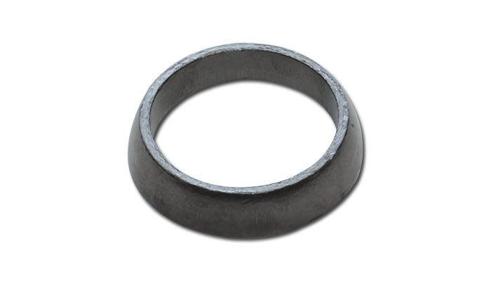

When you took off the original J pipe there should have been a donut gasket around it, It can be reused but good luck getting it off in one piece. As far as i can remember the OBX header comes with only one gasket, the donut gasket will have to be purchased at a parts store. So I am guessing you don't have a gasket where the header meets the rest of the exhaust and that is where your "Dirt bike sound" is coming from. I would have connected the EGR pipe before you bolted the header down.
Here is a picture of what you need.
^+1 above. Given that you didn't get rid of your OEM midpipe, this "donut" gasket should still be attached to it. This should get rid of your leak and line everything up. As for the EGR not fitting - I guess that's ebay headers for you.

@bigpturgeon: correct, I didn't realize there was a gasket attached to the j-pipe still as it all looked like one piece! I just went out and looked at it and it is firmly on there, any prying to try and get it off and you just flake it to bits, so I'm supposing definitely order another one of those xD hopefully that one gasket will fix the leak, because I hate the sound right now it's almost embarrassing...

It is embarrassing and i guarantee once you get the gasket it will go away.
Tweak the parts some more until you can clear the master cylinder. All that rattling that you think is "ok so far" will wear a hole through the cheap cast aluminum that most eBay intakes use. You can try cutting the first silicone piece until the elbow is almost flush with the throttle body to gain more clearance. Most eBay intakes use cast elbows that are made to (hopefully) fit many different cars. Intakes made for the Protege will have tighter cast elbows or a silicone elbow to clear the master. Excessive rattling between the intake and master can also be caused by worn motor mounts.
Are you sure you can't get the donut gasket out without damaging it? I know all cars are different, but on my wife's Civic, it came off pretty easily. Maybe I had to take a flathead screw driver and gently hammer it off, but I don't remember any difficulties. Pretty sure I just took it off by hand... Try letting some PB Blaster or penetrating oil sit on it for a while; it couldn't hurt. You'll save money and waiting on the parts. And you can fix that leak once and for all.
the order has been processed! ordered a set of new spring bolts and got some extra nuts just in case (never hurts to have some extra!), and got the midpipe gasket. about $23.50 total w/ shipping.

@008: I will try looking at the intake again to see what I could do to fix it touching the master cylinder. To even get the MAF sensor to fit the couplings that came with it, I had to heat up the coupler (weirdly, only the one closest to the air filter end) so i could stretch it over the MAF and then tighten it down after I stretched the rubber over the plastic MAF! I put the coupling on my corolla's engine as it was running to heat it up (i kept checking for malleability and how hot it was getting) I finally got it hot enough to stretch over, I thought it was a good solution though.

@lostmybook: yeah, i tried. It was cooked on there, very flaky and just eroded. I just put in the order this morning anyway, can't wait though! :D
