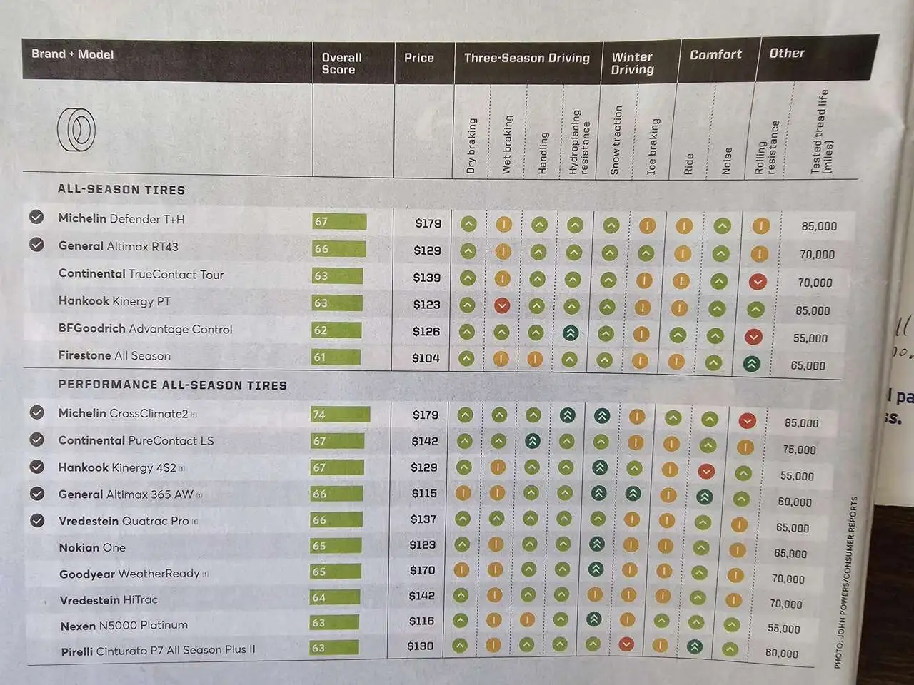

Do you use snow tires or all-weather tires? Some all-weather tires are very good in the snow.
Yes, like the General Altimax 365 for use on snow.
