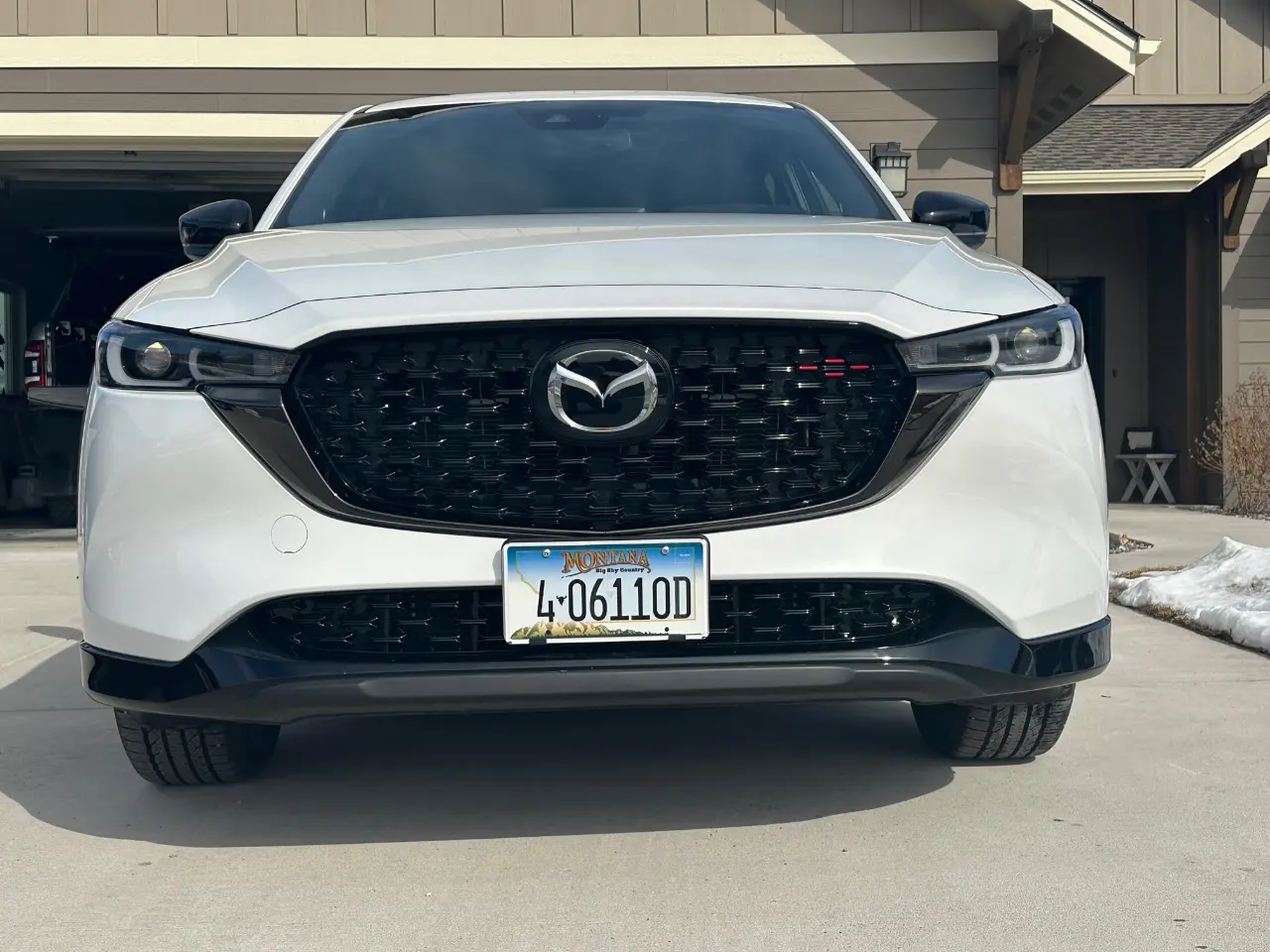

We traded out 2021 Mazda CX5 Grand Touring Reserve for a 2025 Mazda CX5 Turbo Premium.
Our 2021 had 49k when we traded it earlier this Month.
I know the new vehicle is not broke in yet with only 600 miles on the clock.
The old Mazda loved to live at 80MPH on the highway. I don't know why but it was effort less. The old Turbo could be heard and felt more peppy.
The 2025 feels sluggish compared to the 2021.
Does anyone know what changes Mazda had tweaked on the turbo/engine from 2021 to 2025?
I appreciate any information and happy to be a part of your community.

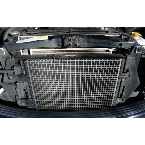

Pix of your lowered CX5 please...and the air filter box mods!
Also, does the ECU keep track of how many times it has been reprogrammed, like Ford does?
Great MPGs by the way.
Does the unprotected intercooler bother you at all? Just looking at made me think about doing something to protect it from road debris, rocks, etc. before it gets all bent up...
No but that's a freaking great idea! Going to do it now.
Here is the progression as I developed a stock filter box CAI. Post #24 shows pics.
2024 CX-5 Turbo Air Filter Box Test - Yikes
Yes, I'm concerned about rock damaging the cooler. On another vehicle I have with 270K mi, I pulled the radiator this past summer and "combed" out the fins and dug out about a dozen small rocks. Also back flushed the dirt out of it. I bought an aftermarket radiator grill with screen to help protect it like this one. You would think if someone made one like this for our CX5s they could sell them....
I don't have any really cool pics of the CX 5. I need to take some...
Intercoolers are not cheap....$700....or there abouts...these little grill pieces help keep some stuff out of the intercooler but of course won't stop a bear.....
