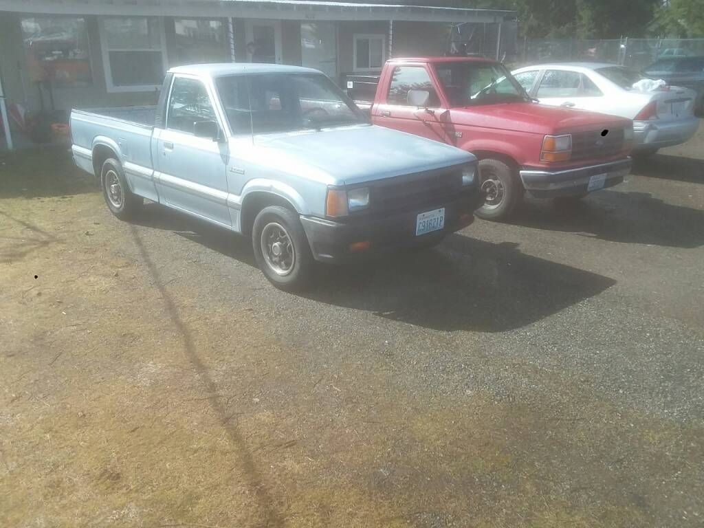

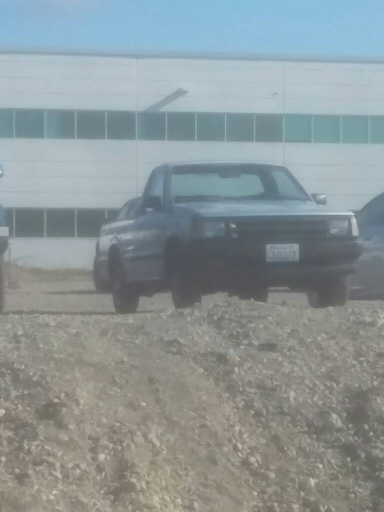

Hell ya some progress! I'm glad your keeping it for a bit longer, my buddy's ranger has gone through 3 alternators from autozone in the past 8 months. He just keeps replacing them under the warranty, we've gotten real fast at changing it on the side of the road haha
