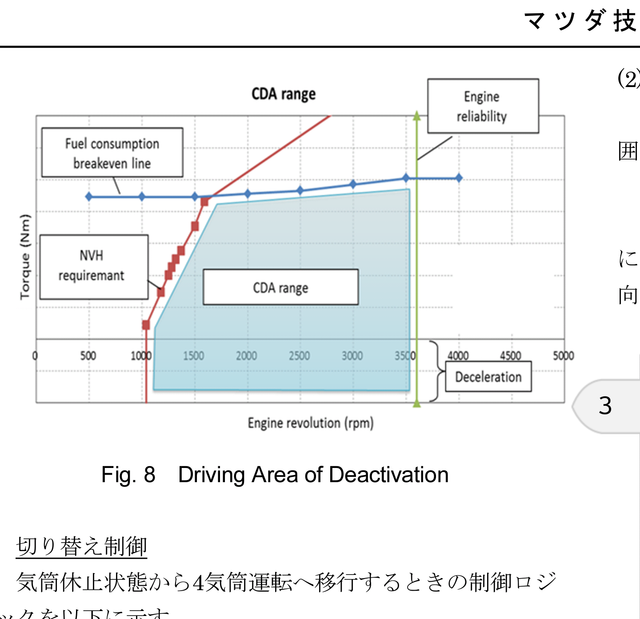

seems to be based on RPMs and Torque.

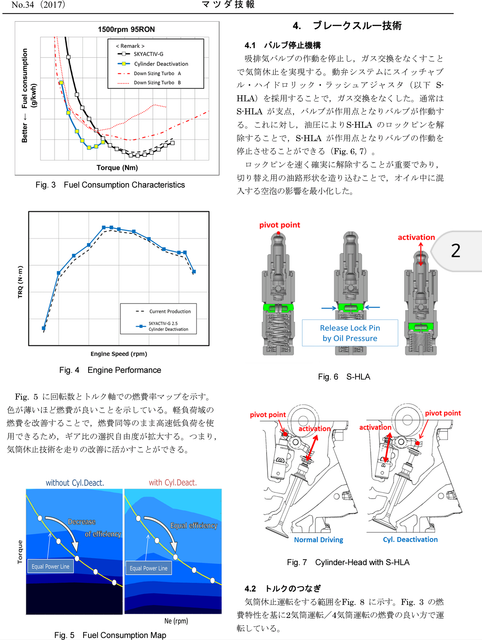

This was the only more technical info I could find from a japanese page apart from the generic info on blogs and news pages.
Unfortunately they have not listed the torque values on the graph.
I am asuming CDA kicks in the 50-120 torque range. i.e partial engine load (steady speed, not climbing) and between the rpms referenced.
It is for the NA engine. not turbo.
They also do all kind of tech.magic to eliminate vibrations, resonance, etc during CDA on,off...there is also a resonator air box (if you look before the air filter) which plays a role too.....so I appears very hard to notice it in the real world.
There
If it's based on RPM's and Torque as the graph suggests why do all the Mazda sites I've seen only make reference to CDA occurring between certain speed ranges? And what doe Engine Reliability and NVH have to do with this?
Also, the bottom text when translated say these are plans to make a robot version of Godzilla. Just saying...
トルクのつなぎ 気筒休止運転をする範囲をFig. 8 に示す。Fig. 3 の燃費特性を基に2気筒運転/4気筒運転の燃費の良い方で運転している。
Fig. 8 shows the range in which the torque is connected and the cylinder deactivation operation is performed. Based on the fuel consumption characteristics in Fig. 3, we are driving with better fuel economy for 2-cylinder operation / 4-cylinder operation
