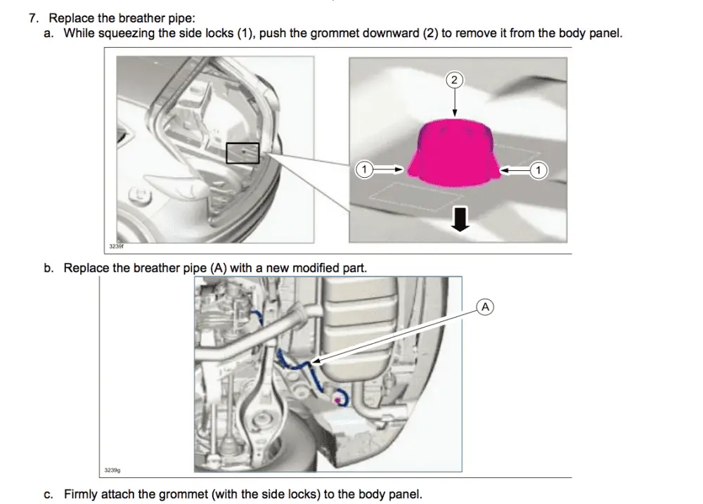

These potential rear diff design flaws below are what I am more concerned with failing
I feel confident in fluid I am using.
Yes, I’m also worried about these inferior companion flange oil seal、“insufficient durability” of differential mount bushing、and water damage to internal wiring harness since I plan to keep my CX-5 as long as I can. Thanks for reminding me ⋯. 🙁
I've ordered the replacement diff breather/vent hose mentioned in TSB to address that potential problem
KE02-27-090
Wonder if that is what caused Unobtanium's rear diff failure years ago?
KE02-27-090
Thanks to remind me and I also need to order this differential breather / vent hose mentioned in TSB. Please update us if the actual replacement doesn’t require dropping the rear differential!
Unobtanium’s failed rear differential at least helped Mazda to find out this differential breather / vent hose was having design flaws letting the water in to the rear differential, as the TSB came out 9 months after his differential failure.
Unfortunately he may never know his contribution to Mazda for fixing this issue ⋯ ;)
