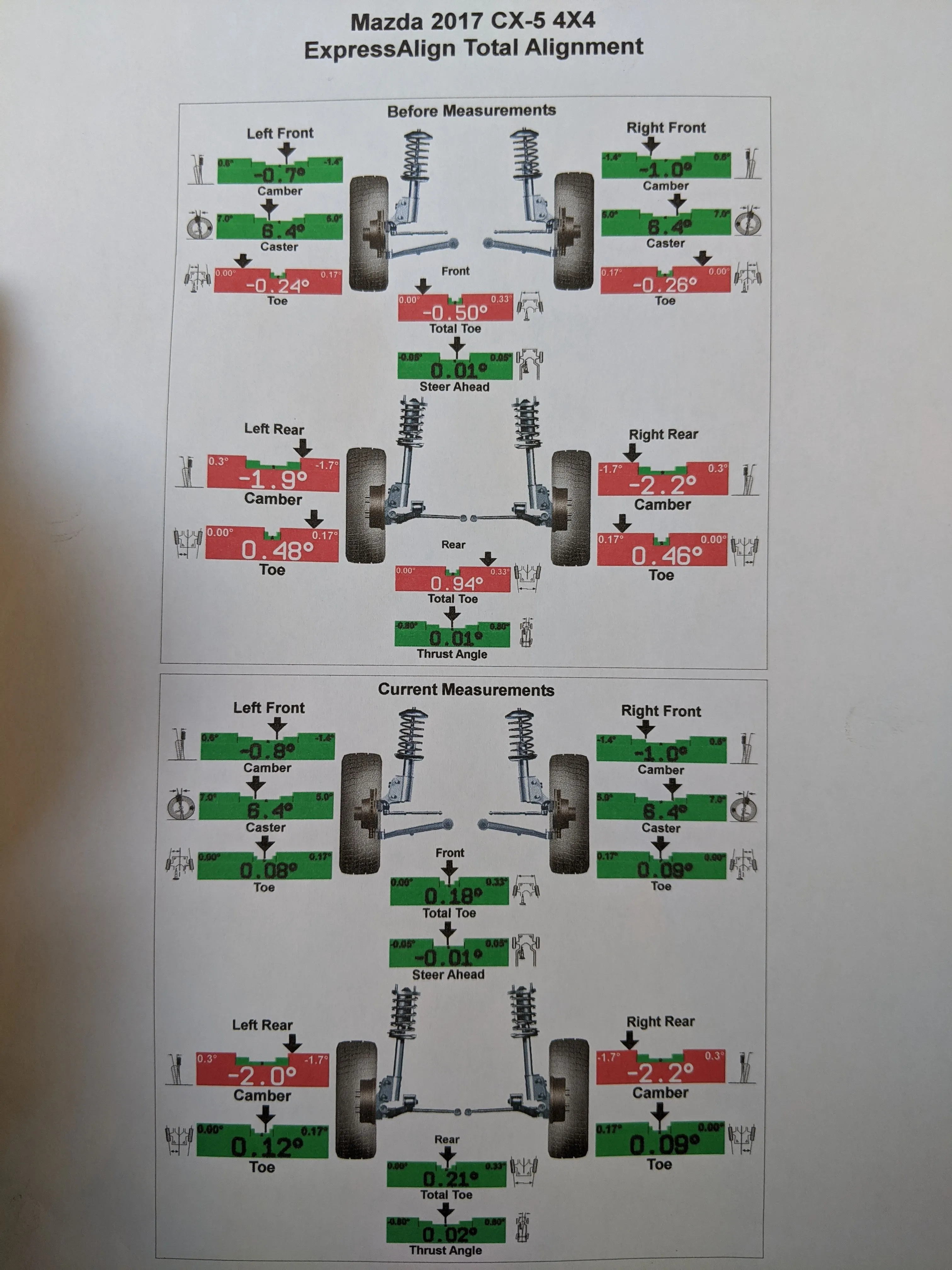

Hey bTwix, I was just taking a look at your alignment readings and as a 16 year tech at Ford, I have to question it. I understand you trust the shop, but I'd ask another shop to do a simple alignment check and give you the current readings to compare to the previous shops printout. I'll explain why.
After replacing the coils and performing the alignment myself on our machine at the dealer, I can tell you that the factory caster and camber both at the front and the back are not adjustable. Toe is the only asjustable angles on the CX-5. Here's where your printout doesn't make sense. The right front caster/camber were in the red on the "before readings" and they shouldn't be. It would have been impossible to adjust them both to within spec. Even by tweaking the subframe, it only equalizes the readings side to side and since the left was almost bang on, it doesn't make sense how the right front was brought within spec. If you look at my "before readings" the front caster/camber did not need adjustment. Only toe. And the same story for the rear, there's only toe adjustment, so how they brought the rear camber into spec. also does not make sense.
I don't mean to questions the shops alignment, but I'd recommend you have a 2nd opinion somewhere else. It may be the machine was out of calibration? Which would explain the red readings on the right front, but still wouldn't explain how they adjusted angles on a car that can't be adjusted. There's no magic here unfortunately.

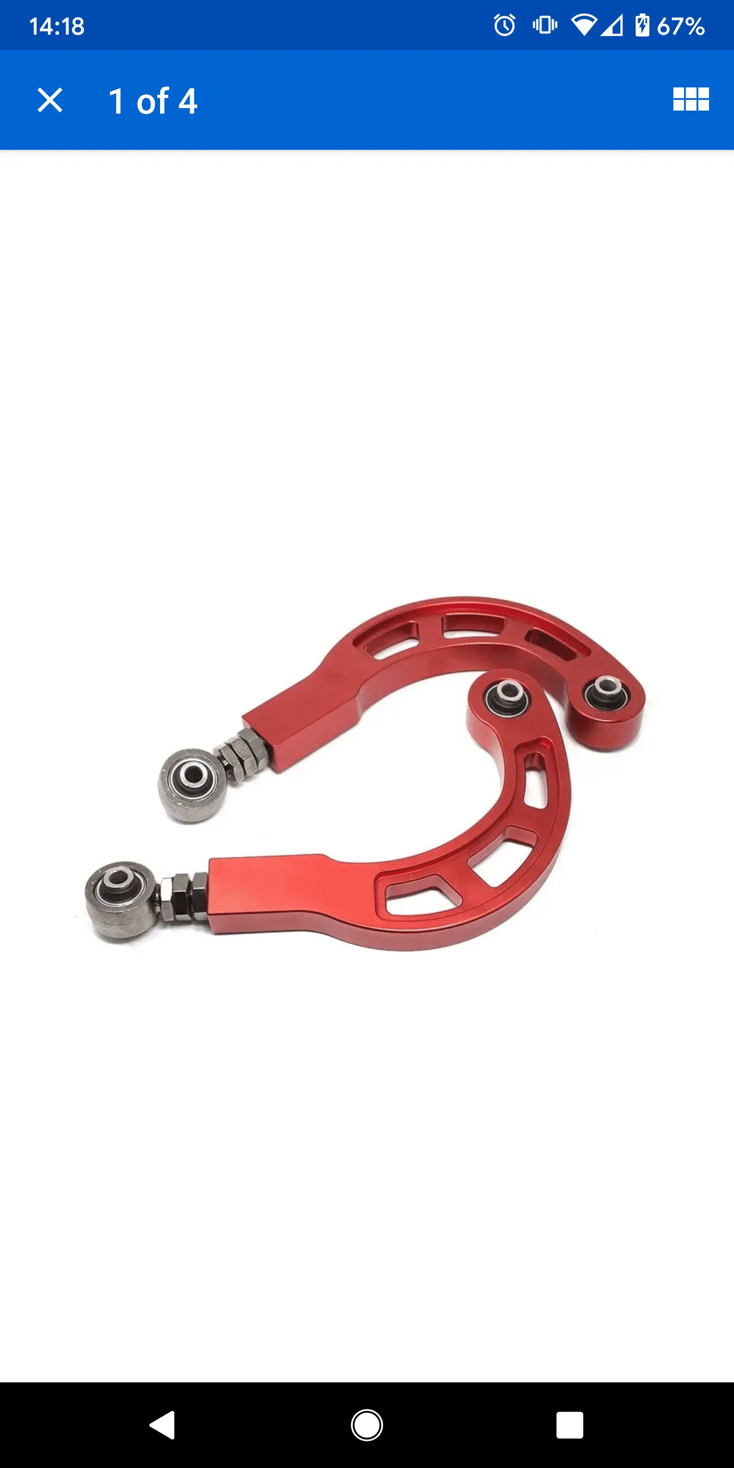

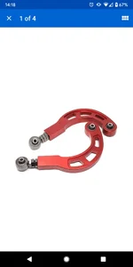

Just removed my winter wheel setup and got my 20”s back on (Eibach Pro-Kit). Did an alignment again and rear camber was at -2.1 degrees (spec is -1.7 max). Alignment shop recommended these for $87 to adjust camber and toe.
Will order and check back in after re-alignment completed
Hey @Aces72Aces, thanks for posting your results. I have very similar readings for rear camber. -2.0 on the left and -2.2 on the right. I'm glad to see someone else on here has similar camber issues with the Eibach Pro-kit.
A few guys on here with 2019 CX-5's posted that the rear alignment was within spec. although they haven't confirmed their measurements. Makes me wonder, are there changes to the rear suspension of a 2019?

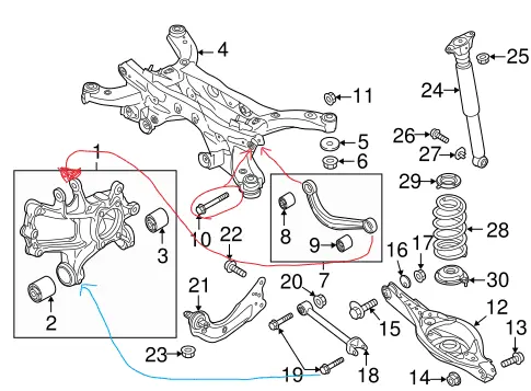

As for the SPC Performance 67416 camber kit, it will work just fine. It replaces the lower camber arm and adjusts the bottom of the wheel in-ward to correct camber. You will need 2 kits though, one per side, so you know.
The upper a-arm that i got, it replaces the upper arm and adjusts the top of the wheel out-ward. Althought much more difficult to replace because the subframe needs to be lowered to gain access to the inside bolt. Which for me is not an issue because I am replacing them myself. It was the cheapest option for me. $135 for the kit:
https://www.amazon.com (commissions earned)
Upper arm red and and lower arm blue

I compared the rear suspension part numbers between 2017 and 2019, and they are all the same. Safe to say a rear camber kit is necessary after lowering any CX5.
You're right, visually it is noticeable!
Agreed. Maybe not right away but after a break in period up to a year
