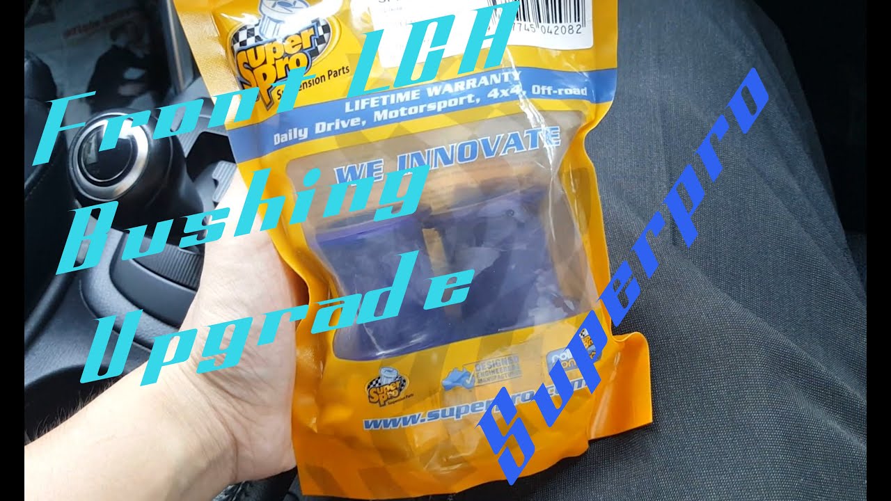

Check your Lower control arm n ball joints.
