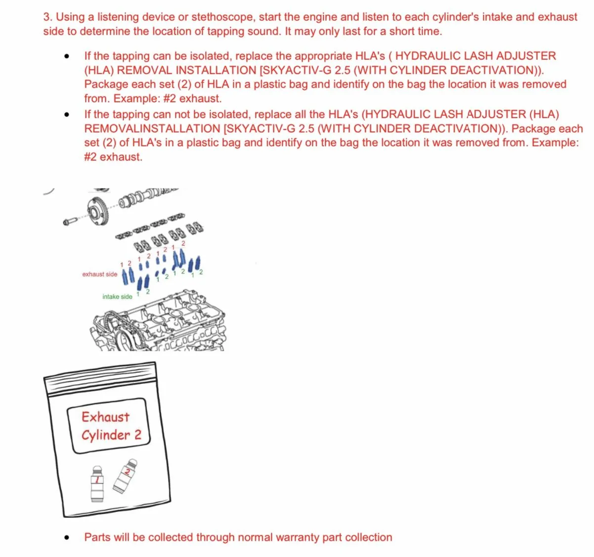

Our CX-5 (2018, grand touring FWD- ~45000miles) makes this noise almost every time driving it. It usually goes away after half an hour or so. We mentioned it to Mazda but didn’t have the video at the time, they said what we described sounds normal . Does anybody know what it could be? Or is it infact normal?

		 thats not the normal for this engine.
