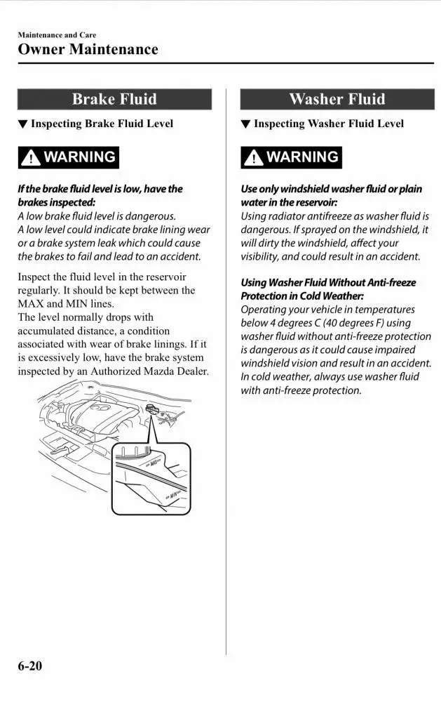

Edit: manual states:
The brakes and clutch draw fluid from the same reservoir. Inspect the fluid level in the reservoir regularly. It should be kept between the MAX and MIN lines. The level normally drops with accumulated distance, a condition associated with wear of brake and clutch linings. If it is excessively low, have the brake/clutch system inspected by an Authorized Mazda Dealer

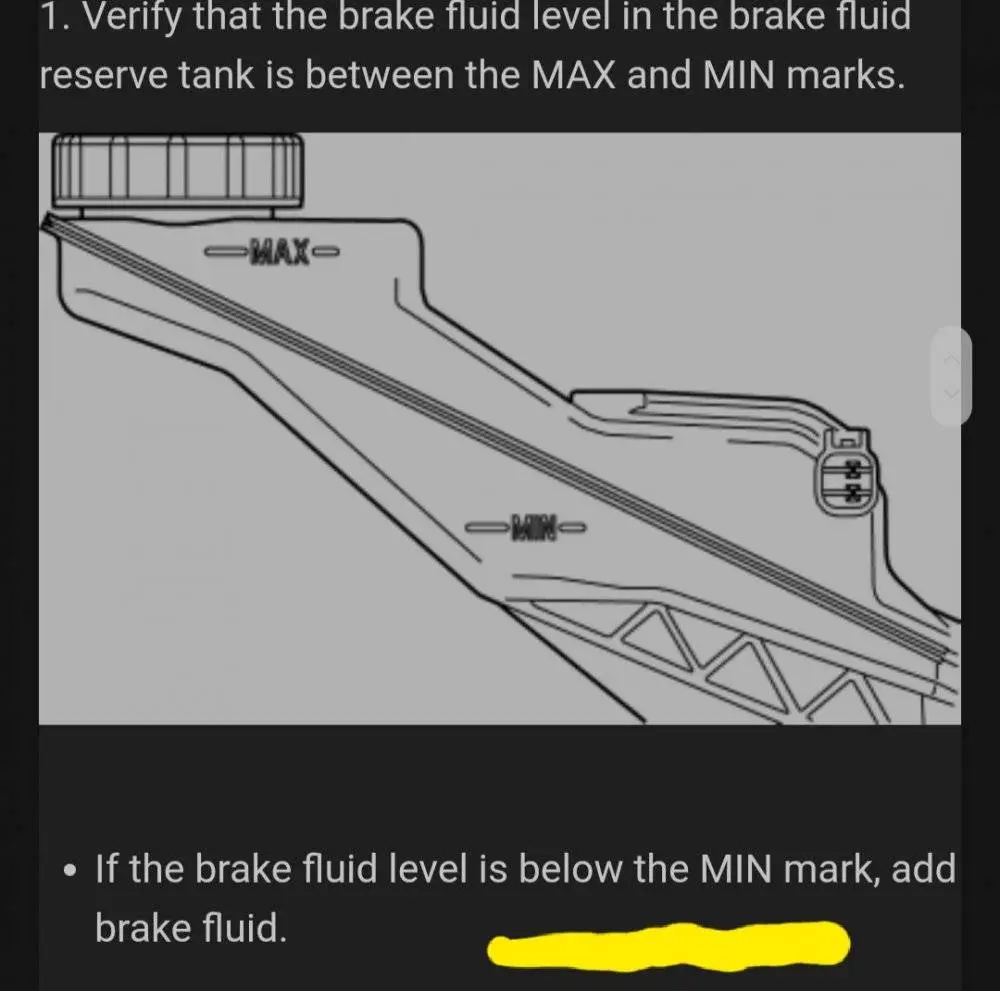

Yes your issue on brake fluid level drop is rare. Not like engine oil、automatic transmission fluid、rear differential gear lube, the brake fluid on CX-5 from factory seems to be always at proper MAX mark. I believe your memory on brake fluid level which was at MAX mark when your 2019 CX-5 was brand new is correct. The loss of pretty substantial amount of brake fluid in 12K miles is not normal, but such leak somewhere in the system may not be easy to spot, as the brake fluid with such a slow leak wouldn’t be dripping to the ground.
Do you know if the brake fluid level had dropped below the MIN mark when you refill the brake fluid? Did you use recommended SAE J1703 or FMVSS116 DOT-3 brake fluid?
At this point you can only keep an eye on brake fluid level, and hopefully you have enough time to show the dealer on unreasonable brake fluid level drop before your new car warranty expires.

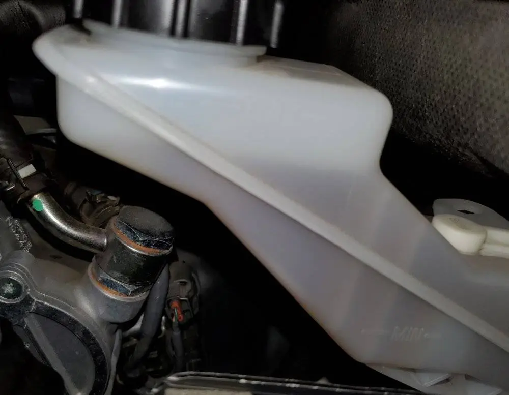

Here is mine at around 13k-14k if that helps.
And that level is normal.

Was it to the max line when purchased? Others have stated their level has not dropped from the max line. Mine was about the same level as yours before I topped off.
edit: why do you think this is normal? I don't think I ever had to add brake fluid to any vehicle I owned.
It was near the max but not at the exact line that has written 'max'.
