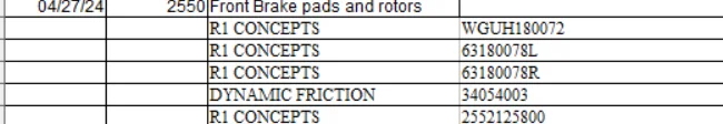

I changed the front brake pads and rotors, drilled and slotted the first month we got it. Oem squealed and dusted.This helps stopping quicker and not as likely to warp. My partner rides the brakes and warps rotors. I decided to start with upgraded rotors this time..
