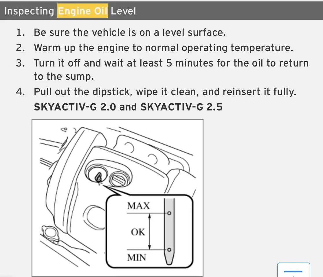

For the 2020's, the North American manual says this on page 6-27:
"Inspecting Engine Oil Level
1. Be sure the vehicle is on a level surface.
2. Warm up the engine to normal operating temperature.
3. Turn it off and wait at least 5 minutes for the oil to return to the oil pan.
4. Pull out the dipstick, wipe it clean, and reinsert it fully."

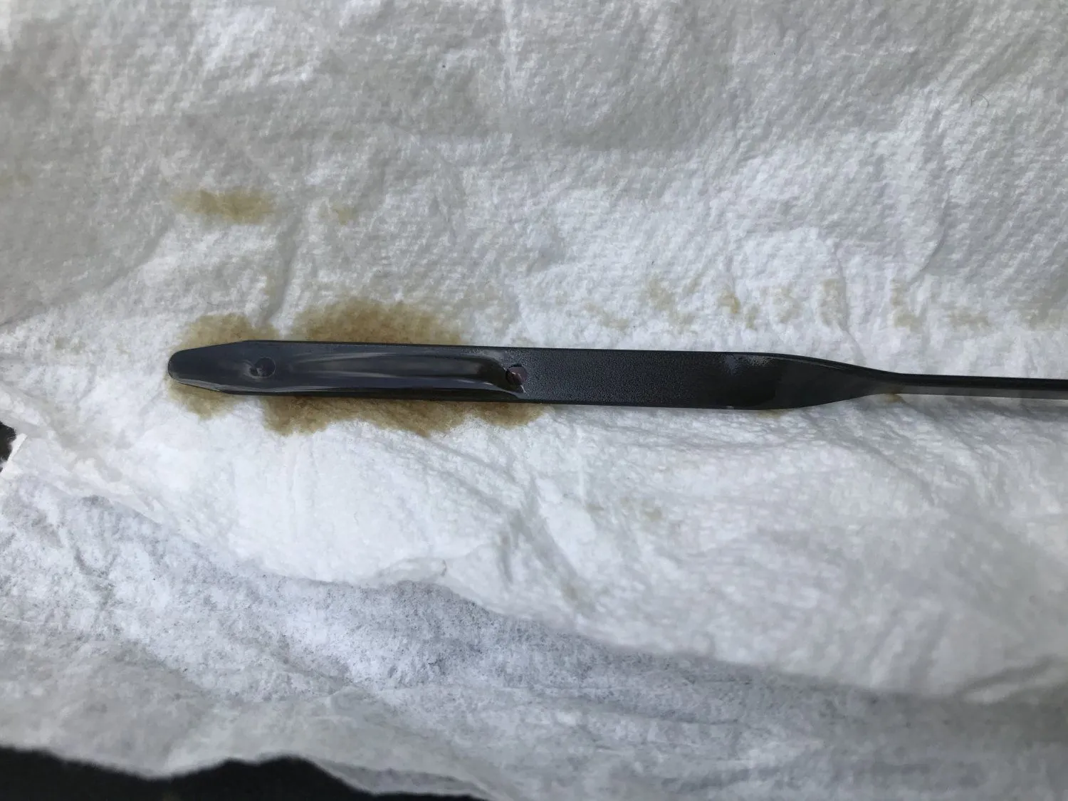

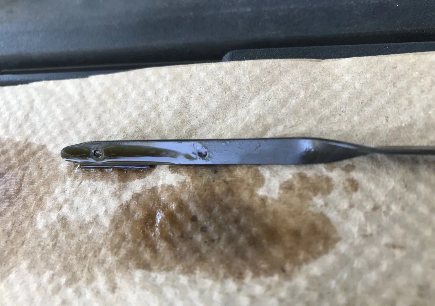

I agree. In theory, checking oil level the first thing in the morning before the engine start meets “wait at least 5 minutes for the oil to return to the oil pan” criteria. And we can check the tire pressure at the same time too.
I’d already compared oil levels on my 2.5L 5-minute hot engine and the first thing in the morning cold, there’s almost no difference between the 2. But checking the oil level cold is much easier.
Hot:
Cold:
I did an oil level check after driving my CX-5 around for about an hour and make sure the engine is fully warmed up. Then I turned it off and waited at least 5 minutes for the oil to return to the oil pan. To be exact, the picture was taken 10 minutes after as I had to take the measurement multiple times due to the difficulty of reading the hot and watery 0W-20 oil on the dipstick.
And here’s the oil level taken at the first thing in the morning on a cold engine before the engine start. No wiping, one pull, and easy to read the oil level on the dipstick:
As we can see, there’s almost no difference between the oil level measured in hot engine and in cold engine, just like dunhillmc’s pictures showed.
The case is closed!
5. Pull it out again and examine the level. The level is normal if it is between the MIN and MAX marks. If it is near or below MIN, add enough oil to bring the level to MAX.
So I need to turn off the engine and wait at least 5 minutes for the oil to return to the oil pan. Instead I actually waited overnight (at least 5 minutes) making sure most oil returned to the oil pan then checked the oil level. I believe I followed manufacture’s recommendation checking the oil level! ;)
