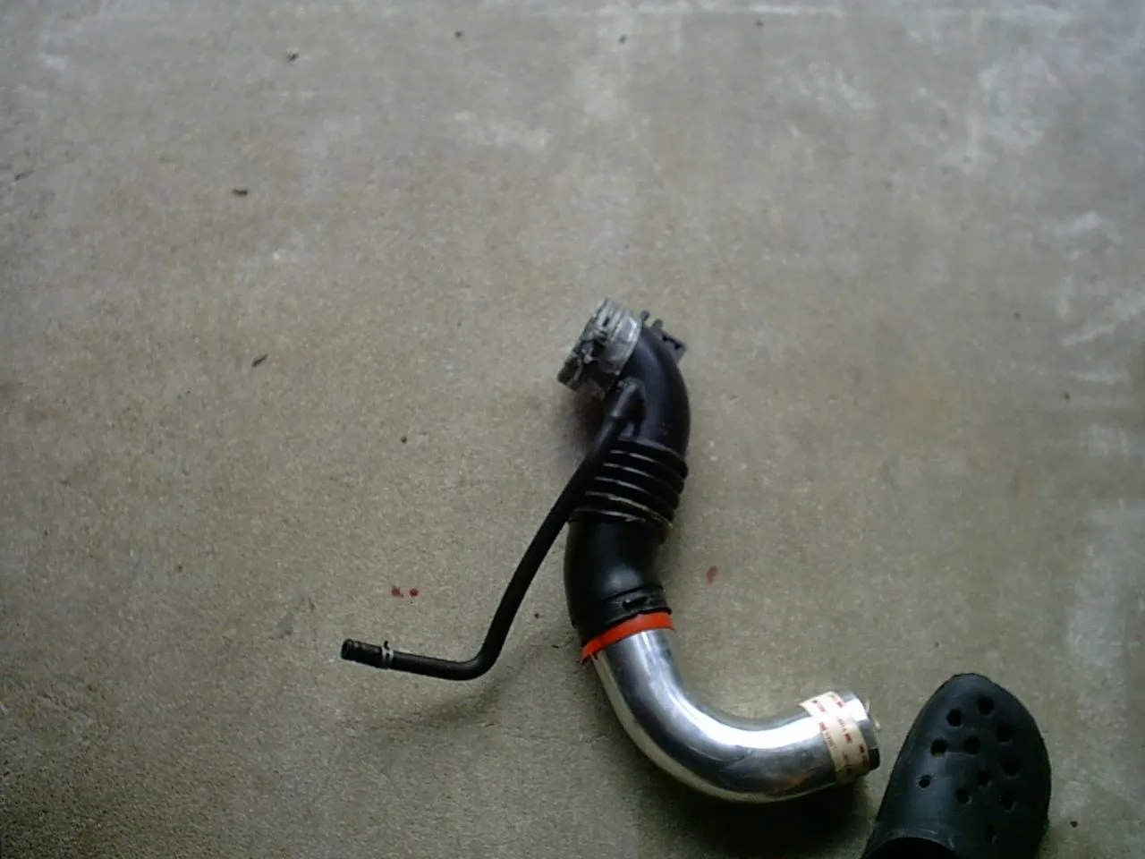

Looks like i got too happy.:( Where you talking about like this??? because theres no where for the MAF(flame2)

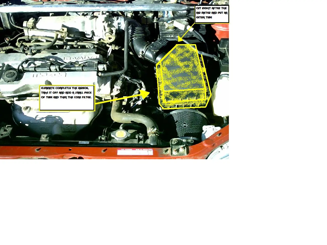

This is what i been thinking of, tell me what u think
Might be the BEST way to get rid of the airbox noise/power restriction!!!
this is the best idea, i did this back when ky car was non-turbo, and it yielded the best results, i had the nice fancy coldairs, and short rams, and they sucked balls.
when i chopped the stock box off after the maf and threw on a filter it worked great, no hesitation.
So how's the noise with that idea i came up with?? Sounds high?
What size filter would you use?
