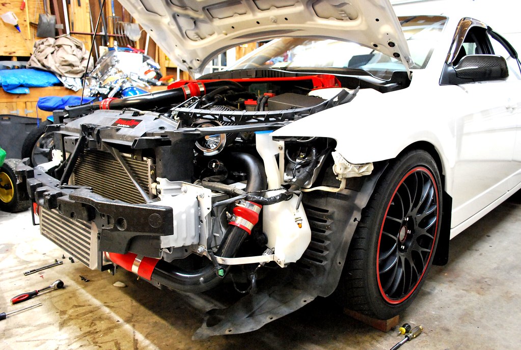

Where did you get the brackets? Also do you have a link to the IC you purchased? Fitment is awesome! Have you had an issues with couplers popping off after you cut the piping? Very Nice looking install!
Hey Qwick i just bought the same exact intercooler and im waiting for it to come in. My plans though are to try and fab a FMIC kit that i can still use my MSCAI without having to change it to a SRI. Do you think this would be possible? I havent had a chance to look behind the bumper and see what kind of pipes and couplers i could use to do this but i figured if CPE could do it why not. What do you think?
Not sure how that would work since its a tight fit in that area. Here is a pic with the setup. Front bumper and headlight removed.
I think it is possible but you would have to remove the bracket on the CAI and possibly how it connects to the turbo inlet to get it closer to the fuse box. Wish I still had my mscai for a test fit.
Well im thinking of running the pipes on the cold side differently. Im trying to run them the same way the cp-e pipes go through or the corksport one
How did u cut the impact bar can u take some pics and show me I'm curious to see how u did it cause IDE like to not have to cut it if I don't have to thanks
with a grinder.
the crash bar is not fully solid but essentially 2 sections in a D shape with a connector in the middle.
One can just trim it right down the middle to get the extra inch he got.
You actually get about 2 or 2.5" more. I used a reciprocating saw. It was a fight getting it cut but I got it done. That along with triming out 2 rows on the plastic grill in the front of the car.
