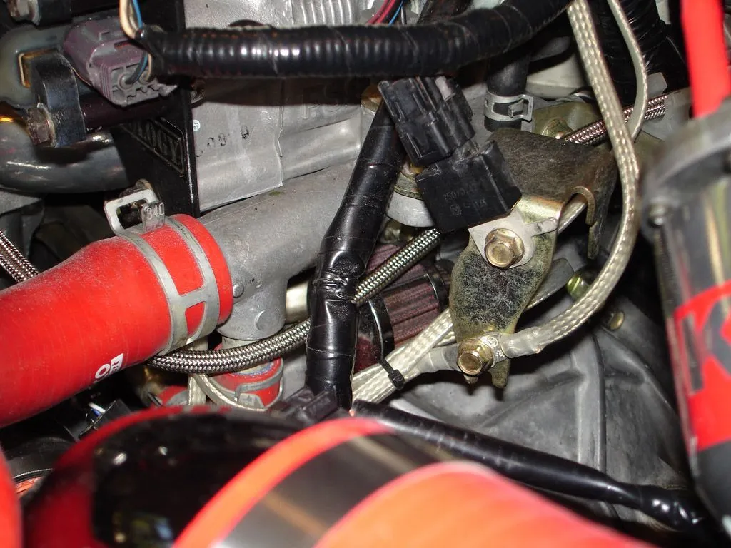

Keep the EGR pipe hooked to your intake mani, and cut it short so that there's only about 9" of pipe. Stick a breather filter on the end, and your CEL is gone. THat's what I did. Worked liek a charm for months. You can see here my breather filter that I put on it, just under the water neck.
good call. KOOLDINO, DO IT.
When I did that, my car would wig out within the first 2 miles of driving every time I drove it.
Wierd... Mine ran perfectly. I actually got the idea from another member (forget who but yellow P5 turbo) and he also had no problems with it.
thats allowing un-metered air in, leaning out your motor when the egr is open i'm thinking connecting it back to the intake after the MAF would cause less problems since you're only letting in air that is metered. i might give that a shot when i get back home. can't wait.
