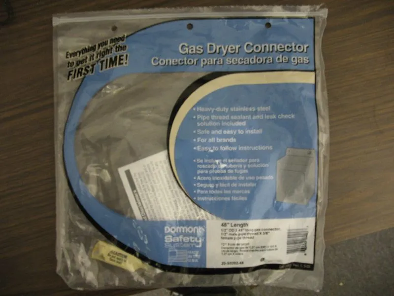

Will do. Ill get a pic of the bag it came in right now actually.
EDIT: Picture is up. I got the 48" one because thats all they had, it reaches with a good amount extra. I sized it up earlier today. Ill get more pictures when I get the tube on tomorow.

Could you take a pic of the tubing and the threaded ends? Did they thread right in, or did you need adapters?
I needed adapters for the ends. I went today but ended up buying the wrong sized adapter for my hose. Ill try again probably sunday or monday. 36" should be plenty. As soon as I can get to a hardware store (im going on vacation but bringing the car) ill get some pictures. Not sure if I will have internet or not so it may be as late as next saturday before I can get them up. Ill do what I can tho.

So has anyone confirmed if this SS corrugated tubing holds up?? Also how does the tubing connect to the connectors?? Also to get this straight the side that connects to the IM is 5/8" and the side that connects to the headers are 1/2". Is this correct??
Wooohooo! I just went to home depot and picked of a SS gas stove line and it already came with three connectors that fit perfectly to the headers and IM! First try! Score! So now I just need to figure out where to run it through the engine bay since it is 48" long(the only one they had). So this will fix my thermal spacer problem and make it way easer to take the IM off in the future.
Nice Score...I've been thinking about this since I had my fiasco with my EGR....Hope it holds up to the exhaust temps...
