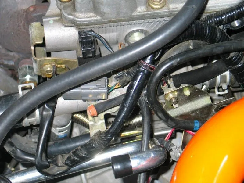

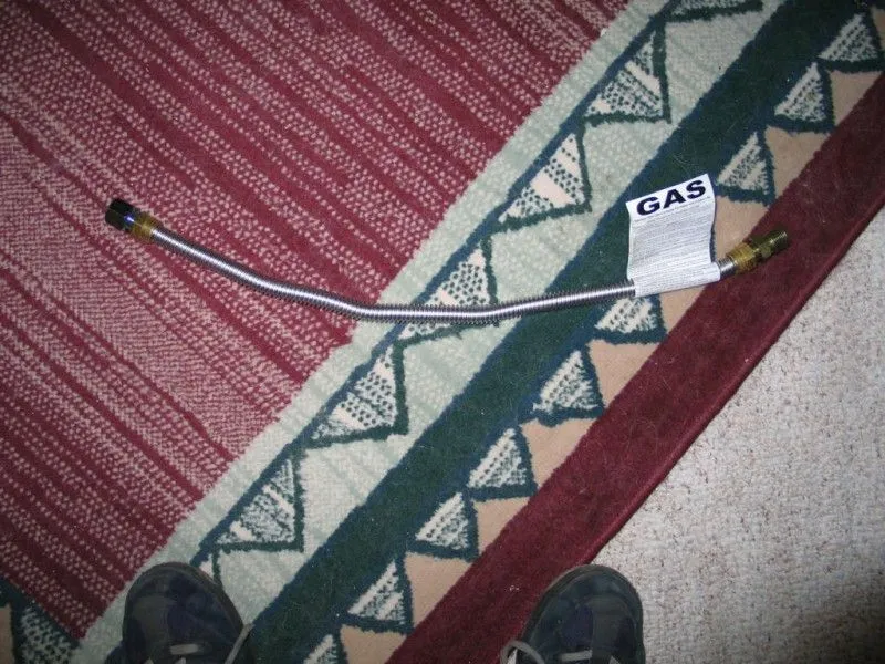

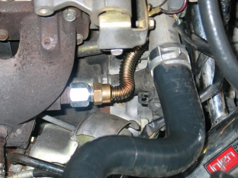

And for the EGR I came up with a different plan if it works which I think it will its a cheap fix, its a stainless steel gas line for a dryer, fireplace etc. I dont know how well this will hold up against the heat but I think it should do the job, and its nice and flexible so installing it is way easier than the EGR pipe.
this is a pic as an example, the one I have was just a couple inches longer than the egr pipe so it fit pretty well

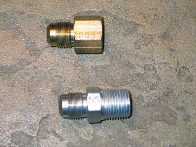

tekkie said:
here is what you need, left side 1/2" flare, right side is 5/8" flare on the top one, and 5/8" on the bottom one, the pipe I used is 1/2" SS

I just got back from lowes with the tubing. I bought a kit that came with the connectors I needed as far as i know. Ill let you guys know how it works when the car cools down and I have a chance to get it on. I found it in the appliance section at lowes.

I went out and discovered that one of the connectors that came in my kit is just a bit to small so im going out and buying another connector tomorow.
