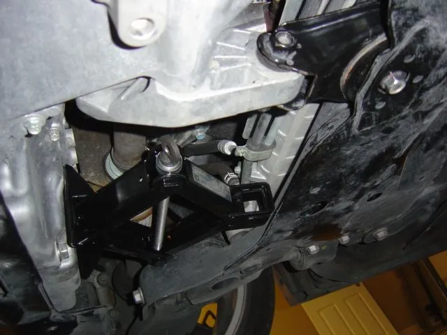

I installed my inserts tonight. I used ramps instead of jackstands, so maybe that made the engine harder to move forward, but I struggled for an hour trying different ways to get enough leverage to move it forward enough to get the mount back in. Congrats to those who were able to remove the bolts on the engine-mounted piece. I coudn't loosen them even by hammering on a breaker bar! They were definitely torqued to WAY more than 70 ft-lbs!
So, after an hour of frustration, pulled muscles, spilled beer, etc., I came up with a different trick - wish I'd thought of it to begin with! I used to jack to move the engine forward. Attached is a pic of where I put it. It's great for one person - you can use two hands to get the mount in! I highly recommend it...
Oh yeah - I didn't notice any additional vibration after the install, and the shifts are much more responsive. Definitely worth the bux (especially if you install it the easy way ;))
