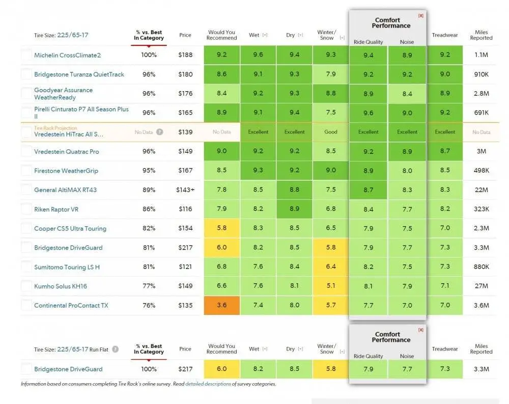

Thanks for the evaluation. Here’s the Tire Ratings Charts on Grand Touring All-Season 225/65R17 tires from Tire Rack:
Honestly from not-too-impressed ratings and price I wouldn’t choose this Cooper CS5 Ultra Touring. There’re many tires which are better and cheaper, and it showed by the second lowest 5.8 “Would You Recommend” rating which is much worse than much-mentioned General AltiMAX RT43’s (7.8).
Thanks for posting this chart and yes I definitely agree with your comments. I am a little surprised that the wet and dry traction aren't rated higher because those were pretty good and actually the best things about the CS5's. I recently reviewed Tirerack's test results and the wet and dry stopping distances (measured in feet) were pretty good.
