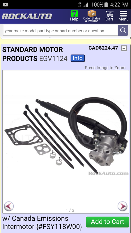

EGR VALVE! EGR clogs and sticks from carbon due to pig rich tune on these things. Pull the egr and clean it out. Do the IAC too while you're there if you haven't already. Canadian EGR valve is better about not doing this. Have cleaned mine once from this and probably need to again but won't mess with it until it acts up......only? @ 98k miles right now and no longer dd for last 8 yrs so might be a minute before it needs it. Guessing I did mine around 55-60k...been over decade since it was issue.
This is the "Canadian" EGR.
It's different in that it has coolant lines attached to it as well as vent tube.
Some guys had to clean their EGR every year.
They had much better luck with the improved EGR.
It's a bit of a chore to install though because it ties into the cooling system.
Canada was the first to have problems with the EGR due to our generally colder climate so it was introduced here first.
PS. It's not listed in the Protege 5 section at RockAuto but is in the Protege 2L section.
Hmmm, IIRC, mine has coolant running thru it and I did bypass because warm climate................maybe, been long time since............
I'm not sure but I think the coolant is to warm up the EGR.
I figure a cold EGR would be more inclined to have dirty exhaust gas condense in it and foul it up, especially when the engine starts burning oil.
I'd have to go see if I ever even installed the bypass kit or not, lol..............
