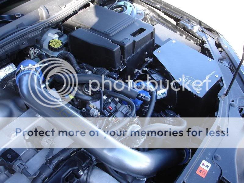

Anyone else equally excited about the cold air box for the cobb SRI? I found the following pic and think this would end the debate about sri vs mazdaspeed cold air intake and the hydrolock issues :)

LOL, so much for the "it doesnt make a difference theory". All that talk about no difference between a true CAI and sucking hot engine air now they MFR a box to keep hot air away?
I do think it looks very well done and cool. I just laughed at the whole debate over this and now to see the thought of them making this means there is truth to the benefit of a true CAI.
Isnt there a little piece of plastic on the grill that you can remove so that it feeds air right into that box? I saw on a How-To thread where a member cut out a piece of the grill meant for the regular 3 air box. It appears as if that box is directly behind it and would benefit best with that section cut out.

I was not involved in the previous slug fest debating pros and cons here. Something I can tell you that others did not, this cold air box for the cobb sri has been in development since they first conceived their intake. It's been on the drawing boards for a while now, and will be a final solution to the issues.

Does the box use any type of routing or ducting to get coldair from that cut-out or from the fenderwell?

The point is, the release of the heat shield by a known hardcore tuning company, to accompany a product which they said a CAI was not needed for this application, further proves that a CAI is superior to a SRI even in this turbo application.....its true. You can realize it now, or you can realize this summer - if you log your IAT temperatures and look at them while driving its unbelievable how hot your Intake Air is after you've sat at a stoplight for only 1-2 minutes, or gone through a drive-thru Taco Bell or something - and then when driving 30mph afterwords, it takes 5 minutes, NOT 5 seconds to even get close to the ambient temp outside. It may be true what other articles have said about how once you get going the SRI intake temp get close to CAI, not with this car, the engine bay sealed very, very well, and it takes minutes to get that air in there, also where is the main source of air come from???? through the already BOILING hot radiator.
To be fair, the SRI works great as it stands now without the box. I would assume the box will help greatly with heatsoak situations.
One thing I have noticed while checking out the SRI on MS3077's car. His car pulled much harder when flogged. However, after a run we popped the hoods on both cars, my intercooler was MUCH cooler than his. So it's not always cut and dried with intercooled cars. If your intercooler has excess cooling capacity it could easily mask the effects of warmer air being drawn in from under the hood. There are a lot of different variables at play here certainly.

Yes I 100% agree. And the truth is, for a cold start, and light warmup run(like dynos, etc) I would even go as far to say that the SRI has less restriction and probably makes more HP. But on the street, after stoplights, etc, and 30mph engaged playing/street races with a heatsoaked, hot ass engine bay - the CAI will be a huge advantage over the SRI.
The way I see it is that with common sense the CAI is still the best and least controversial. Dont drive in 1ft+ standing water and there is no chance of hydro lock, yet no matter how you look at it the intake air temps will always be lower then a SRI located in the engine bay.
You can make theories about a SRI being better or the same or having less risk to water uptake but seriously I would not call it a comparison to a true CAI. It is not a CAI it is simply a less restrictive choice compared to stock and if you have half the money you need to spend for a real CAI then its a good choice.
Or if you plan to drive your car in 1 ft of water it may be a good choice but even then everything under your car is submerged so I would worry about other components at that time. This would further suggest that the hydro lock theory is BS and thus taking one point away from calling a SRI better when considering water traversing, lol.
For me the CAI makes sense and can not be suggested nor theorized as being an equal to a design that draws hot engine bay heat. It simply doesnt and its design wont allow for it. The only draw back is this theorized hydro lock which I think makes no sense. If you had a Jeep then yes get a SRI to keep the intake up as high as possible but then again you are driving a car made for such punishment. Its not like those of you with a MS3 sporting a SRI can go in water and think it is still ok to do so. A few inches more and you will flood the inside of your car so I dont see the benefit of a SRI when considering the one "so called" draw back the CAI has.

Apples to apples, Mazdaspeed Cold air intake is no longer offered, so thats out. Now we whittle down the rest of the field as follows:
Cobb with forthcoming box - excellent all around choice
The rest: draws air from 4 to 5 inches from road ,and hard to install. Tube is commonly made of steel or other heat conducting metal. This also heats the air to a degree. Also, these supposed "cold air" intakes are drawing air from ABOVE the engine cover under the car, guess where the air in this semi sealed space has been all along? That's right, affected by engine heat, especially the exhaust and turbo. and pre heated by radiator as well :)
See how this subject can be debated endlessly?
Also, before someone tries to say that the "vents" along the front of the driver side tire fenderwell allow the intake to draw in cold air from outside, it will pull the closest air it can find, which is already in the pocket area under the regular underhood area. Also, once in motion, the air flowing around the car will cause a suction effect on said air vent, which will guarantee that cold intake doesn't get any cold air. The only viable source of cold air is the grill area, which is precisely where the radiator gets it's cold air, along with the intercooler and batterly cooler. And forthcoming cobb airbox...
