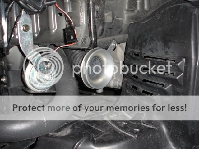

Not sure how the COBB SRI Box is designed but that opening in the front corner of the grill seems ideal for an inlet leading to the box and providing fresh intake air from the outside, almost like a ram air effect.

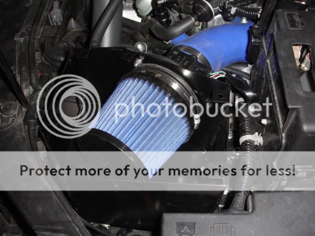

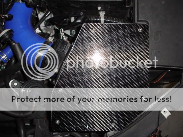

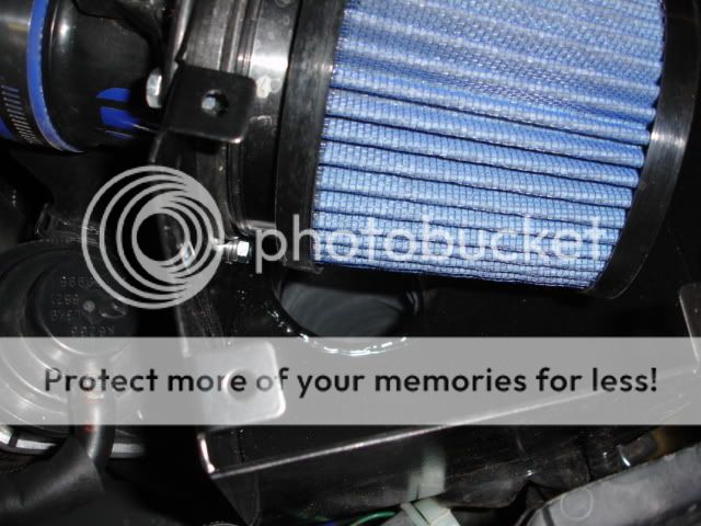

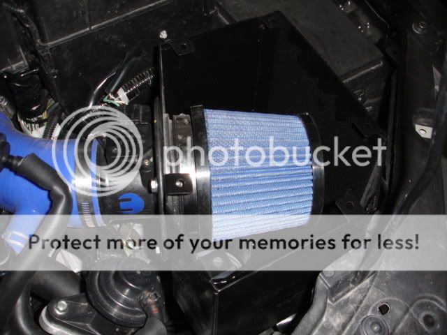

This was the prototype. Stole the pics from the other forum
